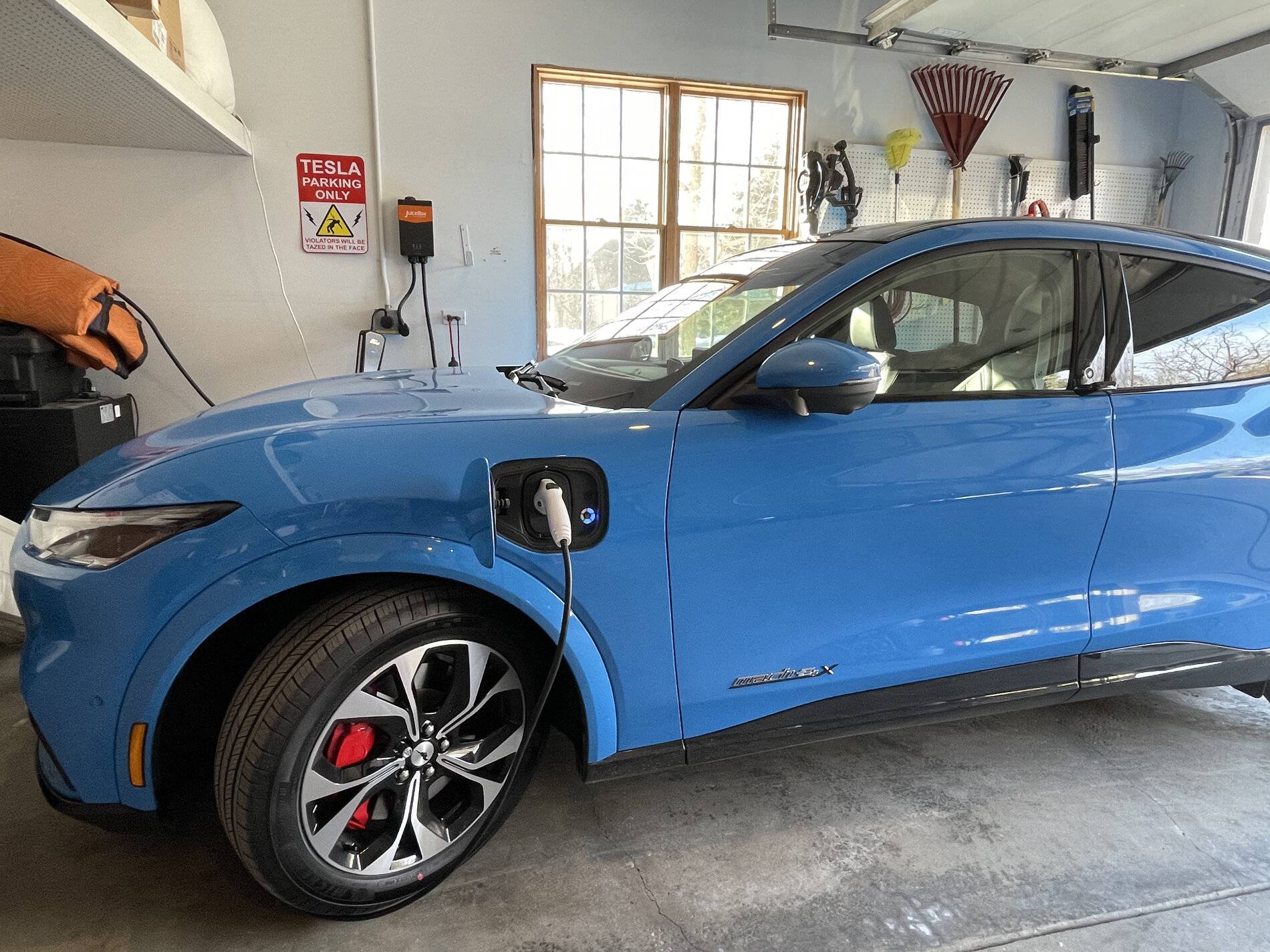

So I am proud to say that I am NOW able to charge the car from my 240V outlet using the Ford Mobile charger. I took the car to the dealer this morning for them to look at it but I do not think they performed any updates on the car. The sales person ended up driving to my house with another MME (35 miles each way) and another charger just in case. But when we got to the house, we connected the car again but this time after we inserted the charger into the charge port, he hit the unlock button. All of a sudden it started to charge normally. Not sure what the unlock button does on the charge port but after he did this, it is now charging from the 240V outlet. I have since taken the car out for another ride and now it is charging again but this time I did not have to hit the unlock button for it to charge. I have no idea what happened but now it seems to be charging fine.
Here is a pic (ignore my old Tesla sign in the background). I need to take that down and replace with something else like a Pony.
No idea why it is working now because unless the dealer did a software update (which I do not think they did nor did they tell me they did anything at the dealership), there is no reason why it should be working.
I will take what I can get! Now I just need to figure out why the tone settings for bass, treble and mid range are not saving after the car is powered off. That is a discussion for another forum.
