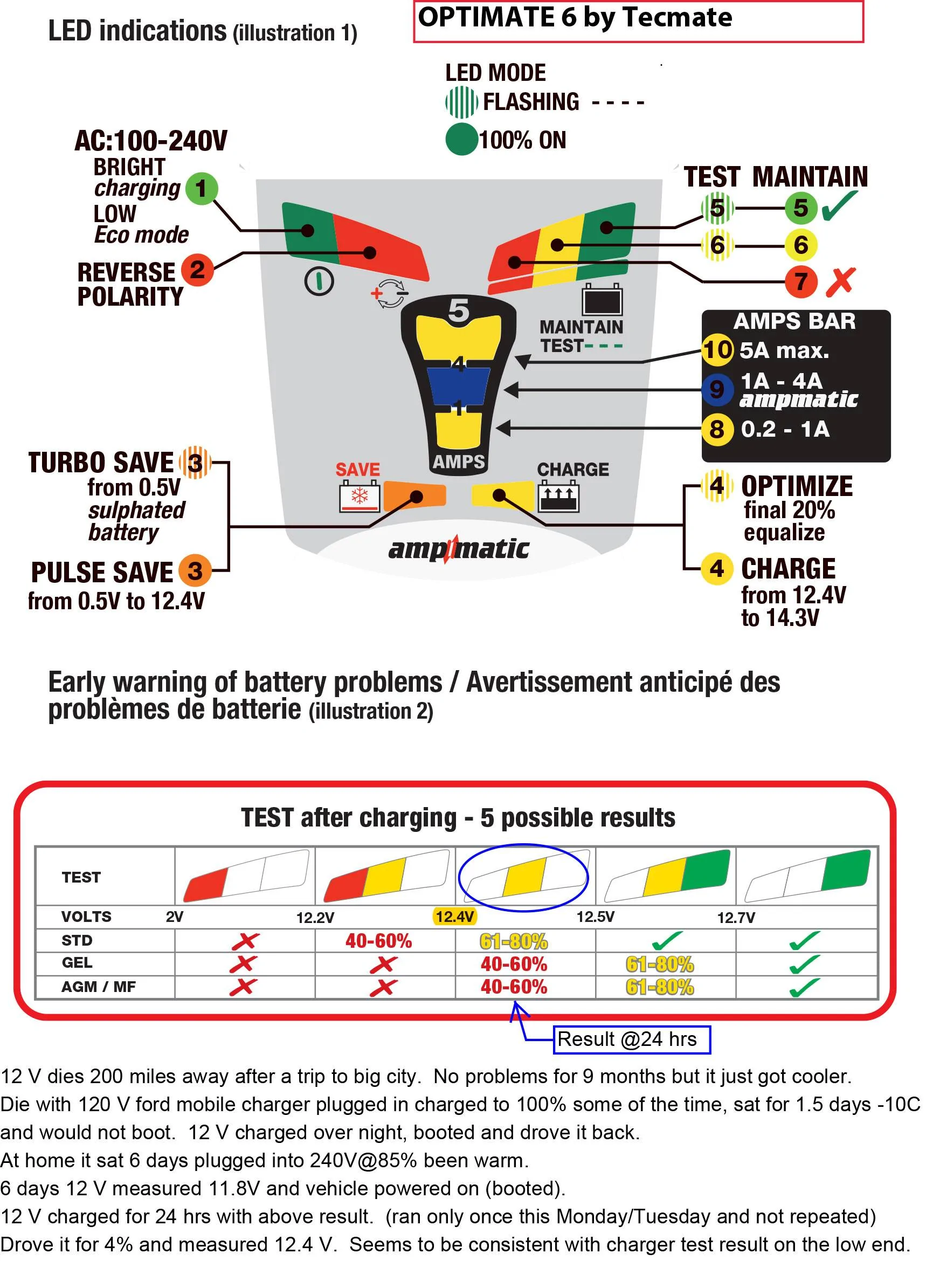

Ran a 12 V charge/test once and it failed indicating yellow 40 - 60% or 12.4V to 12.5 V for AGM. It measured 12.4. We will see what the professionals say when it goes in.

Maybe not but I have switched the dump trailer over to agm as it holds a charge and the tractor over to agm as it takes a beating and does not shake the plates apart in the fields. The charger has come back all good when I charge those . The first failure I have seen with the charger I purchased years ago is this one.
Ford Mustang Mach-E Mach-e dead again Untitled-Extract-Pages
Not saying it is bad and noted let the professionals tell me. I will note however I will not rule it out.
We've also had very good luck with the AGM batteries on our various ranch equipment, including the gate to the house. Plus our 2020 Raptor has an AGM battery. There are, of course, a lot of possibilities for this, and that includes the AGM battery issues on the mach-e.

Was in the shop, diagnosed as bad 12V battery, replaced and came back OK.
Installed
PERFORM 21P22 SOFTWARE UPDATE. UPDATE SOBDM, ABS, BECM, SBDMC, SOBDMB, OBCC, BCM, DOME, DCMF, DCMG, DCMH AND RFA MODULES. CLEAR ALL DTCS. RECHECK. ALL OKAY
Installed
Feeling good to be in the above 80% group?. ;)
glad to hear it was *just* the 12v.....
you might wanna edit the Original Post Title to include [solved - bad 12v battery]

Sat 8 days 17th to 26th. Plugged in a new Christmas present and this is what I got.
Ford Mustang Mach-E Mach-e dead again Screenshot 2021-12-26 at 12.21.18 PM-1
After 8 days the 12V started at 75% and charged to 91% when powered on (started). Appears the battery is taking a charge now. Wondering if it sat for two weeks if it would be below 75%?
Does anyone know what is normal while sitting and at what % sync will charge the 12V battery or does it not maintain the 12V when parked? Appears the battery health is better to test it again. Hoping the battery was the cause not a symptom. Time will tell.
