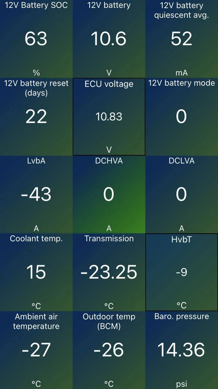

Saturday morning -30C (-15F) woke up to a charging fault so went out to check it as that is the sign.
Unplugged, started and errors
Service AdvanceTrac
AWD Off
Service Vehicle Soon
Pre-Collision Assist not available
Stop safely now
Vehicle will not go in gear.
When I plug 240V back in get all red port lights.
Car dead again. 12V dead again and brand new. Bad 12 V appears to be not the problem. Third time is the charm and need it fixed this time.
Should put the 12V charger on it. Does anyone know if it can be too cold to charge a 12V (damage)?

Thankyou for the info the charger started at save (snowflake) and then swithed to charge 4 amp.
It is alive again with a 12V charger and then fired up and charged itself to 82%. Left it running (started) until it got over 80% where it dropped to 1 amp. It is even showing puddle lights tonight so it must know it misbehaved. ;)
Wondering if the first error code may have something to do with it?

U0151(00)
Raw code: C15100
ECU: ABS/ESP[Archive (inactive)]
Status: Confirmed, Test failed since last DTC clear
OBDII: Data bus, supplementary restraint system (SRS) control module - no communication
============329==============
U3513(00)
Raw code: F51300
ECU: BECM
Status: Pending, Confirmed, Test failed since last DTC clear
============330==============
U3517(00)
Raw code: F51700
ECU: BECM
============331==============
P0AA2(00)
Raw code: 0AA200
ECU: BECM
Status: Pending, Confirmed, Test failed since last DTC clear, Warning indicator requested
OBDII: Hybrid battery positive contactor - circuit stuck open
============332==============
U0594(00)
Raw code: C59400
ECU: BECM
OBDII: Invalid data received from hybrid powertrain control module
============336==============
U0293(00)
Raw code: C29300
ECU: DCDC[Archive (inactive)]
OBDII: Lost communication with hybrid powertrain control module
============337==============
U2404(92)
Raw code: E40492
ECU: GWM
Status: Test failed (current drive cycle), Confirmed
============338==============
C1001(54)
Raw code: 500154
ECU: IPMA[Archive (inactive)]
Status: Test failed since last DTC clear
============339==============
U2100(00)
Raw code: E10000
OBDII: CAN-BUS Communication Malfunction
============340==============
U3000(49)
Raw code: F00049
OBDII: Control module
============341==============
U0415(86)
Raw code: C41586
OBDII: Invalid data received - anti-lock brake system (ABS) control module
============342==============
B1578(78)
Raw code: 957878
Ford: Lamp Park Input Circuit Short To Ground
============343==============
P0D2D(00)
Raw code: 0D2D00
ECU: SOBDMC
============344==============
P1A07(00)
Raw code: 1A0700
ECU: SOBDMC
Ford: INVERTER HIGH VOLTAGE PERFORMANCE
============345==============
P1A10(00)
Raw code: 1A1000
ECU: SOBDMC
Ford: HYBRID POWERTRAIN CONTROL MODULE - BATTERY DISABLED
============346==============
P2DA7(00)
Raw code: 2DA700
ECU: SOBDMC
============347==============
U351B(00)
Raw code: F51B00
ECU: SOBDMC
============348==============
U351F(00)
Raw code: F51F00
ECU: SOBDMC
That sounds like it might do it (hv circuit stuck open). If the hv contactor cannot close, the DC/DC converter cannot come on to maintain the LVB.
Where is the lever to close it ;). I guess if it still does not close it will do it again. Have no idea if it is intermittent or stuck for good.
Sunday morning it came on for 10:45 AM departure about an hour early. When I got in the 12V was at 97% 13.2V. Drove it 22% and drove great as usual. That night it started to charge at 10 PM as scheduled. ?‍♂
Monday it came on and drew power 5:00 AM "preparing for drive". The 12 V killer appears to be triggered randomly which is not all bad if you have a code system that says Hybrid battery positive contactor - circuit stuck open.
@TheVirtualTim similar problem to the one that was fixed with software last February that effected us? Could it be contacts that kill the first 12V and now is working on the second one? Two times in the three it happened at an ambient temp of around -18F. The other @ around 14F and first time it dropped. All times below 32 (CND 0). Worked well thru the summer but cold has a way of bringing problems to the forefront.
