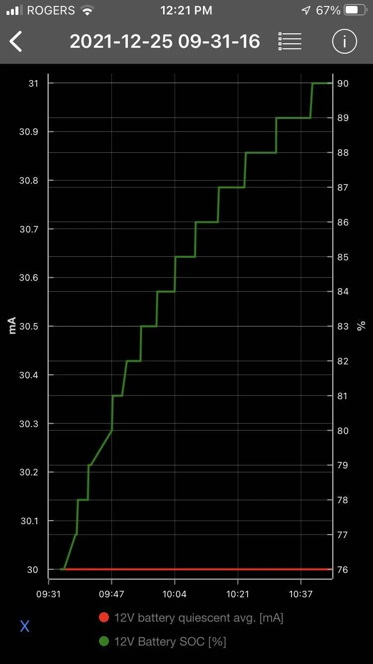

Sat 8 days 17th to 26th. Plugged in a new Christmas present and this is what I got.
After 8 days the 12V started at 75% and charged to 91% when powered on (started). Appears the battery is taking a charge now. Wondering if it sat for two weeks if it would be below 75%?
Does anyone know what is normal while sitting and at what % sync will charge the 12V battery or does it not maintain the 12V when parked? Appears the battery health is better to test it again. Hoping the battery was the cause not a symptom. Time will tell.

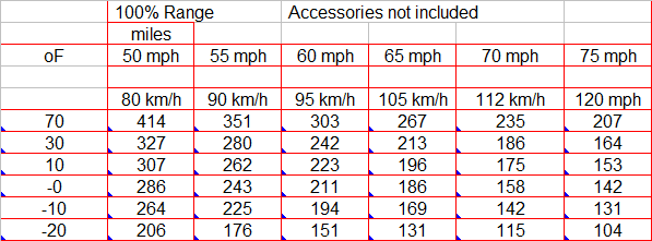

Interesting tests by @louibluey here he has a thread started now here. Initial results indicate the logic lets the 12V drain to near 30% soc before it attempts to charge it. Hoping there is not a huge parasitic drain when at 30% but it is possible with the car in a certain state? There are a lot of states; last February it was right after charging from what I understood and a contact problem. Your 87% has 57% to go before it gets a charge or another 60 hours based on the first 13%. What was the voltage at 100% that may hint on health?
P.S. I am around the 250 mile range for 65 mph @ 68F with a premium awd so your GT sounds about right. Mine is pretty close to what the EPA numbers stated. I have found if I can make the charging stations I have plenty of range. The new DCFC curve is good enough here that I no longer have math base range anxiety. I can get it to 100% at a DCFC @-10F. Charging schedule now works, range now works at DCFC's ............... now if these 12V's could quit dying on me I am all set ;). Guesstimates based on epa of an MME 4x. I think if we drive no faster than 50 mph we are all set ;).

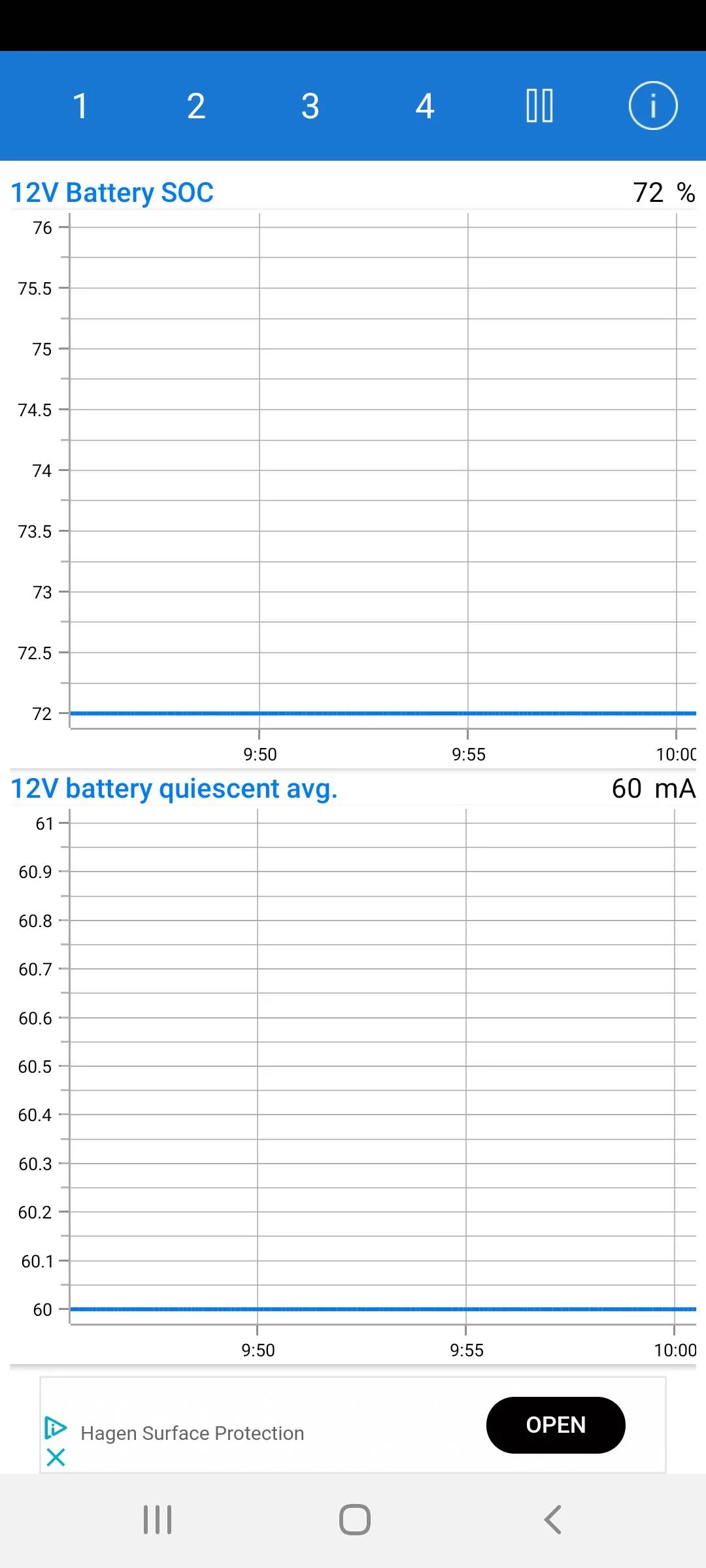

60mA is
Do you lock the car when parked? What is your standby drain (quiescent)? Value can be read with Car Scanner app.
60mA is the standby drain with the car off and locked. I always lock the car, the key fob is far away and I don't have PAAK set up. There is nothing plugged in.
The state of charge is 12v SOC is 72% today after sitting for about 16 hours. It was 90% when I parked 16 hours ago.

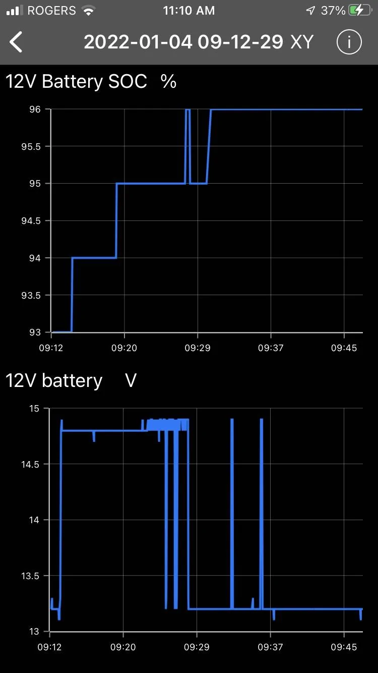

Was going to wait a week but after parked 6 days FP crapped out on me so thawed it out this morning as temps went up to -5C (23F). It has been cold the last week never above 0C (32F) with a constant daytime around -10C (14F) dipping to -28C (-18F) for the last 6 days. Plugged into 240V and saw it pulling power for over 2 hours out of schedule and not charging ?. Not following it too closely and do not care how much it needs. This morning 12V started over 13V, 90% soc and went up to 96%. Feeling better every week.
Ford Mustang Mach-E Mach-e dead again Screenshot 2022-01-04 at 11.10.32 AM
Just a few ups and downs not sure if it is the app?
