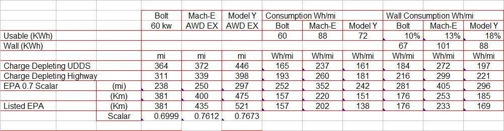

This really really needs to happen and if Ford doesn’t have engineers actively pursuing this goal on they are nuts. Because it would be a huge win and change some minds.
Get the curve humming just below Mercedes for the full session and pump it up to 94 KWh it would be a force to be reckoned with. There is a mustang in there.
The fact the MME went further isn't so surprising at this point, though the size of the range difference is greater than I would have thought.
The big question is: When will reviewers stop using the (obviously bogus) Tesla EPA numbers as a meaningful benchmark?
Based on 0.7 of 2 cycle dyna numbers Tesla should be 297 but the vid says on the bottom end of that. Ford used a scalar of 0.76 also but appear on the upper end with close to a 30% swing? Does this show us EPA test may require tweaking for EV's? It is possible if the variance during Alex's vid is the case. I see no reason to release bogusly low dyna numbers when all it will do is free you up to slap whatever you want on a window sticker. The test or the numbers are a bit weird. Like the error on the side of the good guys thou ;).

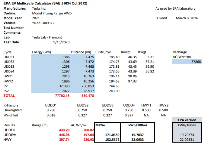

here's the LR Y AWD EPA cert nu mbers and here's the link to the full document. Page 23 for the LR Y AWD. This cert is for the 2021 LR Y AWD but it's the same battery as the 2020. If Tesla eliminated the three additional urban cycles, range drops from 330 to 308. The rated range is heavily slanted towards urban driving and not highway speeds. Take out all the pure urban cycles and you'll see ~ 300 miles.
https://iaspub.epa.gov/otaqpub/display_file.jsp?docid=51237&flag=1
I wonder if Ford geared it towards the real work and said to the epa numbers. I was comparing 2 cycle and not the stuff at the discretion of the administrator. Maybe my math is wrong? Not sure how current my numbers are now either not much sense now I own one. The wall loss on a tesla is the highest?
