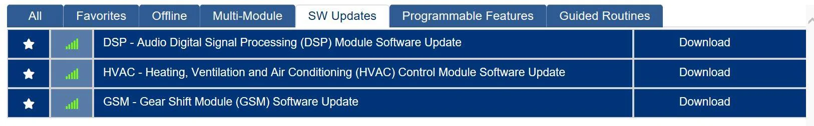

I did not realize that some vehicle service history can be accessed with FDRS, so you can see what was done.
April 13
The dealer tried updating the GWM and accessed the Workshop manual for tests to diagnose Ethernet network failure multiple trouble codes. The second attempt on the GWM worked. The IPMA was updated.
April 14
The CCM, PSCM, CMR, IPC, PCM, SOBDMB, SOBDMC, RFA, IPC, APIM were updated. They reset the APIM twice.

Well just had @Shaggyrn back over to try the updates again with the new FDRS. After trying the IPC update again, it dropped off, then got an APIM, and then a GWM, and then another APIM. Did the double APIM reset, and the hands-free toggle was there, and the BC expiration date was showing in about sync.
However, on the test drive, the blue bubble for Lane centering still won't show up, which means it can't engage into hands free either.
Came back and hooked back up to FDRS, and the CCM and CMR were showing again in the update list, but running them would just do a config and then update to ford and finish within a minute or so then drop off the list. Then OBCC, 2 of the door modules, and the HVAC module showed back up and also just did the config update with the same version of software.
After all that still no Lane centering or BC.
At least all the software is there like it should be. I hope.
