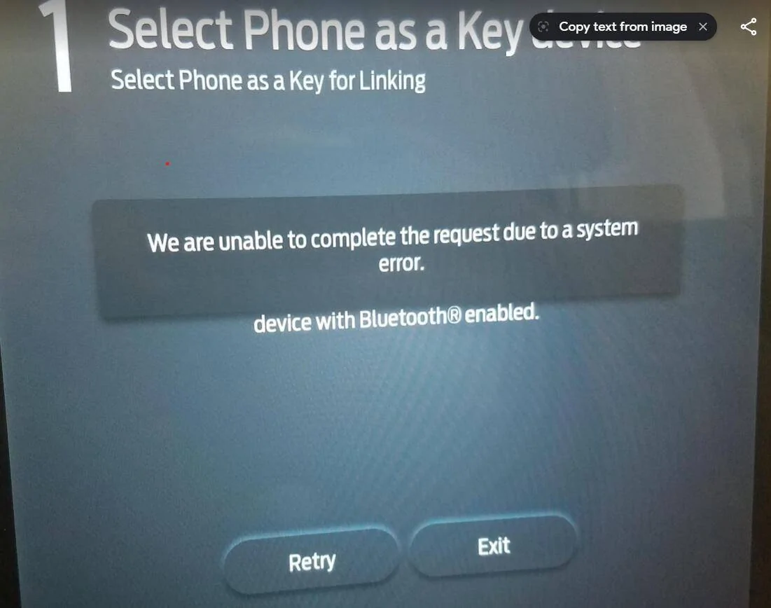

Yup! Did that too. Like I posted earlier full master reset and complete reinstall of fordpass with all setting including vehicle deleted.
This is what happens at the backup code stage.
Just baffled that my phone that largely worked PaaK is essentially kaput right now.
The crazy part is door lock/unlock works but the cars almost acts like the blue tooth is not on at the start up stage.

Ok so I cleared the cache and did another reinstall of app. no dice.
- Door lock unlock works. Which means PaaK is active at some level right.
- Will not start.
- Will not allow backup start code.
- On my profile it does not recognize my phone as PaaK enabled, which it did before.
- My app says PaaK enabled.
- Car says No. But I will lock unlock doors for you.?‍♂
In any case my second fob is on its way. Now I have to beg the dealer to update for me.

Proximity does not work.
But if I hold the button down on the app the doors unlock.
But start does not work. Says no key detected.
Yet my Phone says PaaK is set up but I guess it is not working at all.
Tried 2 android phones both say the same thing.
I'm testing an iphone now.
