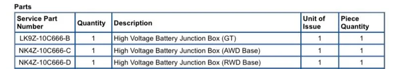

Here’s the old November parts list
Ford Mustang Mach-E Recall 23S56 - HVBJB Replacement / Powertrain Software Update IMG_2743

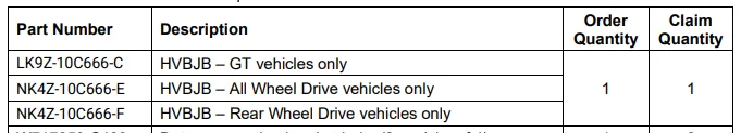

Here's the new December parts list
Ford Mustang Mach-E Recall 23S56 - HVBJB Replacement / Powertrain Software Update IMG_2731
I forgot to look at the prefix. That did change from one C to the other. Presumably that means it's a whole new part and not just a relabeling of the same part.
If so, I'm hoping I get the recall notice since I have the NK4Z-10C666-C.
88
12,939
17,380
Right, the new suffix letter represents a new version of the part. We know nothing about what has changed for any of the three part numbers, other than the suffix letter. As @MachE70 said, we hope that the parts are more suitable. Only time will tell. ?‍♂?

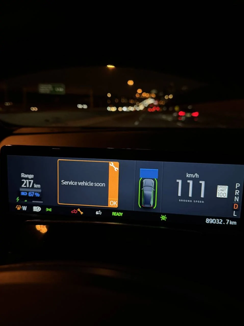

Had my original one replaced at 16,000 km and just got another failure at 89,000 km on the highway home a few days ago…
At the dealership for repairs and they ordered the part yesterday. Hopefully that means it’s the new one, although I’m not sure if our Canadian inventory has been updated. I’m going to ask for the part number on Wednesday after they open again. I have a GT.
I should note that for whatever reason the recall doesn't come up for my VIN. It came up back in October and I got a paper letter but it mysteriously went away a week or two later.

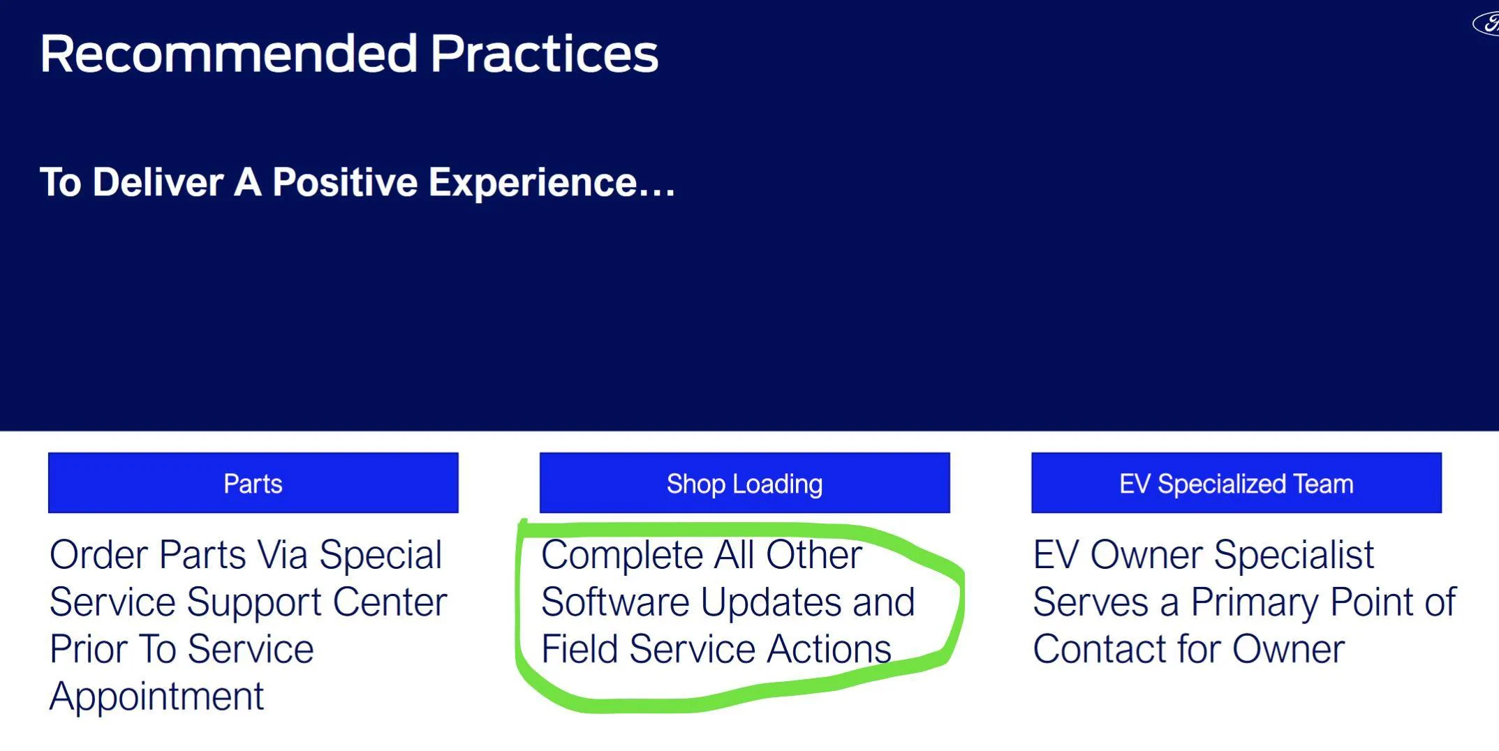

While my car is getting the HVBJB swapped out, will the dealer apply everything that’s available and just sitting in FDRS for it too?
11,351
24,978
No. They'll only do the updates for the current field service actions on your vehicle. Not everything.
