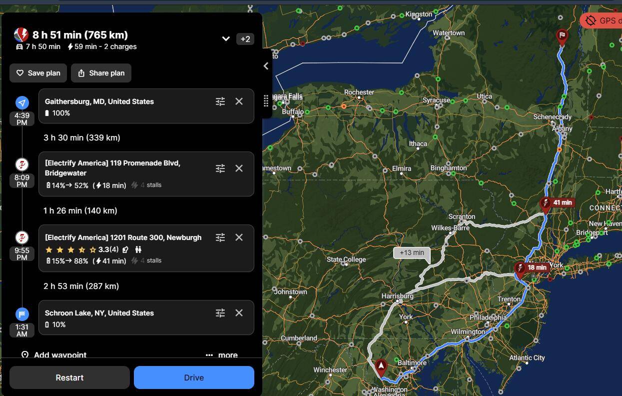

Can I use a Tesla supercharger and if so what do I need to hook it up to my 2023 Mach E? I'm planning a trip from my home in Maryland to the Adirondacks (Schroon Lake) and its 476 miles. I have the standard battery (approx 230 miles), so I'll need to stop around half way. But I don't want to include an overnight stay. So was wondering if I could use one of the Tesla supercharging stations, which would minimize my charging time to a few hours. Suggestions would be greatly appreciated.
OP, Try using A Better Route Planner. Here's your trip mapped out if you're avoiding Tesla Superchargers. Note that your car will natively charge at non-tesla "Superchargers", such as Electrify America, at the same speed, so I think there's a misunderstanding there.
https://abetterrouteplanner.com/?plan_uuid=bca2f676-197c-4e5a-a936-f171157aea96
Ford Mustang Mach-E Tesla Supercharger Question 1719520836108-18
