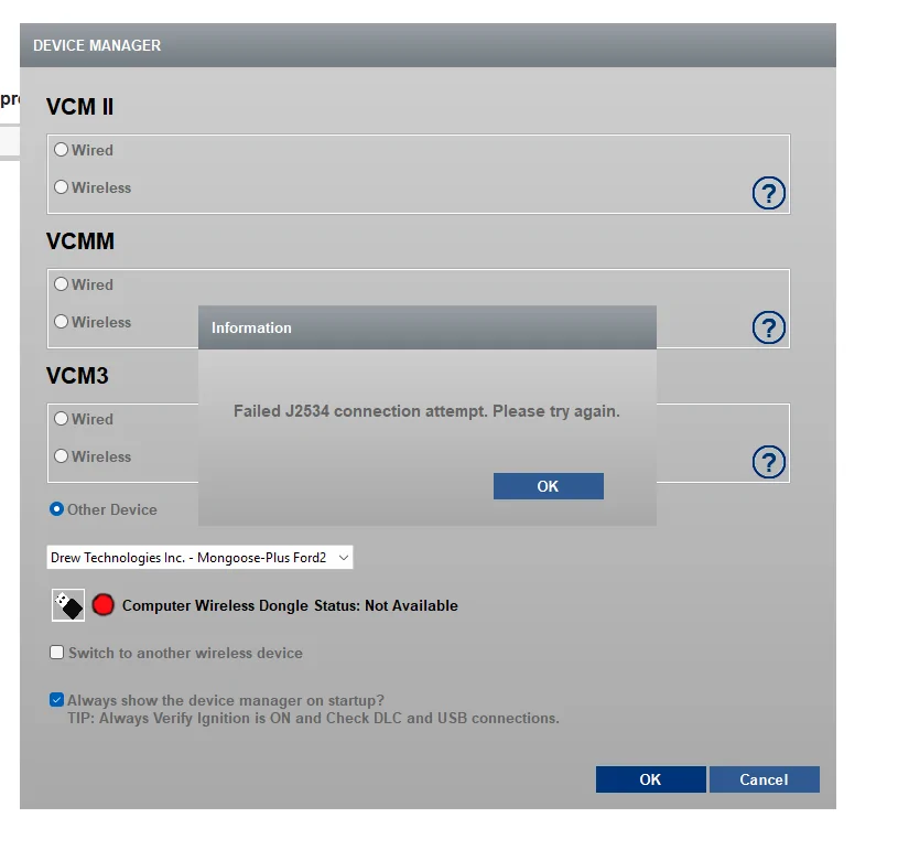

I am helping a forum member and am having some issues getting my Mongoose adapter recognized.
The last time I used it FDRS was still using the long access key method and not the subscription method.
I have updated to the latest FDRS and am getting the following:
Ford Mustang Mach-E The Complete DIY Guide to Updating Your Mach-E with FDRS Screenshot 2026-03-05 122706
Clicking continue ultimately gets me:
Ford Mustang Mach-E The Complete DIY Guide to Updating Your Mach-E with FDRS Screenshot 2026-03-05 122821
Any ideas why my Mongoose cable is not seen?

Seems like everyone with a Mongoose is using an older version as they’ve experienced the same issue.
kdonnel
Oct 31, 2021
35
1,147
1,665
Metro Atlanta
2022 CA Route 1, 2020 Bolt EV
What version do I need to use? You mean FDRS, right? I am using 47.6.9.
I have tried a bunch of different versions I had in my downloads folder.
47.6.2, 46.5.8, 46.5.4.
I went as far back as 45.5.7 but that version does not work with the subscription method.
I also tried forscan and it connects fine to the car using the mongoose cable.
Any ideas?

I had uninstalled the VCI software and other than changing the dialog box to no longer offer up VCM II. VCMM, and VCM 3 as options, FDRS still refused to acknowledge that the Mongoose was connected.
I installed 46.5.4 again, the oldest version I had that supported the new subscription method, and it still complained that the connection failed.
To make sure the Mongoose had not crapped out, I fired up Forscan and it had no issue using the Mongoose to query all the modules.
It was after using Forscan and firing up FDRS once again that it suddenly worked.
So confusing.
I wonder now if it would work with a newer version but didn't want to rock the boat.
In the end I got the forum members car updated and my own.
