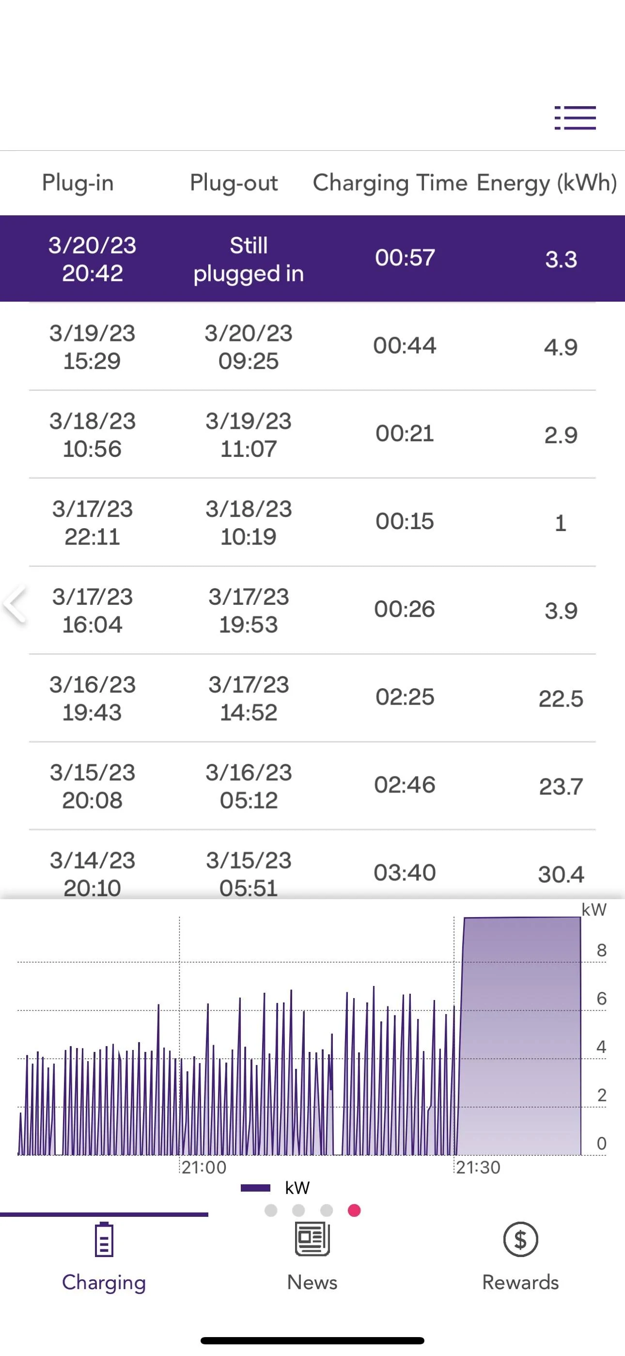

My car randomly starts and stops charging over and over again on L2 chargers. As soon as it crosses 24 amps it stops and restarts. The closer it is to full the worse it is, for example if I try to charge it at 83% it happens more often than if I charge it at 43%. If it’s cold it seems to make it worse also. Sometimes it just goes away on its own. I’ve been told to bring it in but I both haven’t had the time to do so and my dealer hasn’t exactly given me confidence in the availability of a loaner to use right now while they try to sort this out. I’m at 9k miles so when I bring it in for the 10k I will try to get this resolved. You can see a picture below of the charger behavior if you're interested. The car always chargers eventually. Also, if I drop my charger to 16 amps I can charge no problem.
As to your issue, I have had that happen as well at an EA location and from what I gathered from people at the charger it is usually the EA charger and not the car. The guy next to me said to call EA and ask them to reset the charger and sure enough, that worked instantly and I was able to charge.
