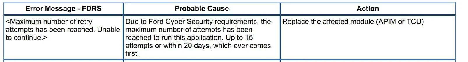

I have just read the TSB 22-2166 again and towards the end it says
The US version TSB22-2150 is now superseded by TSB 22-2404 which has at the start in big fat bold ..
CAUTION: Due to Ford cyber security requirements, the module repair procedure outlined in this article is limited to a maximum of 15 attempts with a total of 20 days from the first time the application is run before the application is permanently disabled for each unique VIN. Make sure that all required and compatible tooling listed in this article is available prior to performing this procedure to reduce the chances of encountering this lockout state. If a lockout occurs, module replacement may be necessary. Note that even if the application is run successfully, the 20 day timer (allowing 15 attempts) continue to run in the background. If the module repair application has successfully completed in the past, it is not required to be run again.
So I guess the clock is ticking for me now unless they already had 15 attempts. Moral of the story if you are having this work done. Ensure they have all the cables/adapters mentioned in the TSB prior to giving then the key and ensure they can disable their AV and thoroughly read the TSB beforehand
I'm booked in for December but as you can see they don't sound confident.
Evans Halshaw Altricham after giving it its 18k valet service advised me go elsewhere for these complex updates. Ford have now set up an appointment with TrustFord Wilmslow for them to diagnose and if necessary replace the module. @SteveUk Have you had any further joy?
