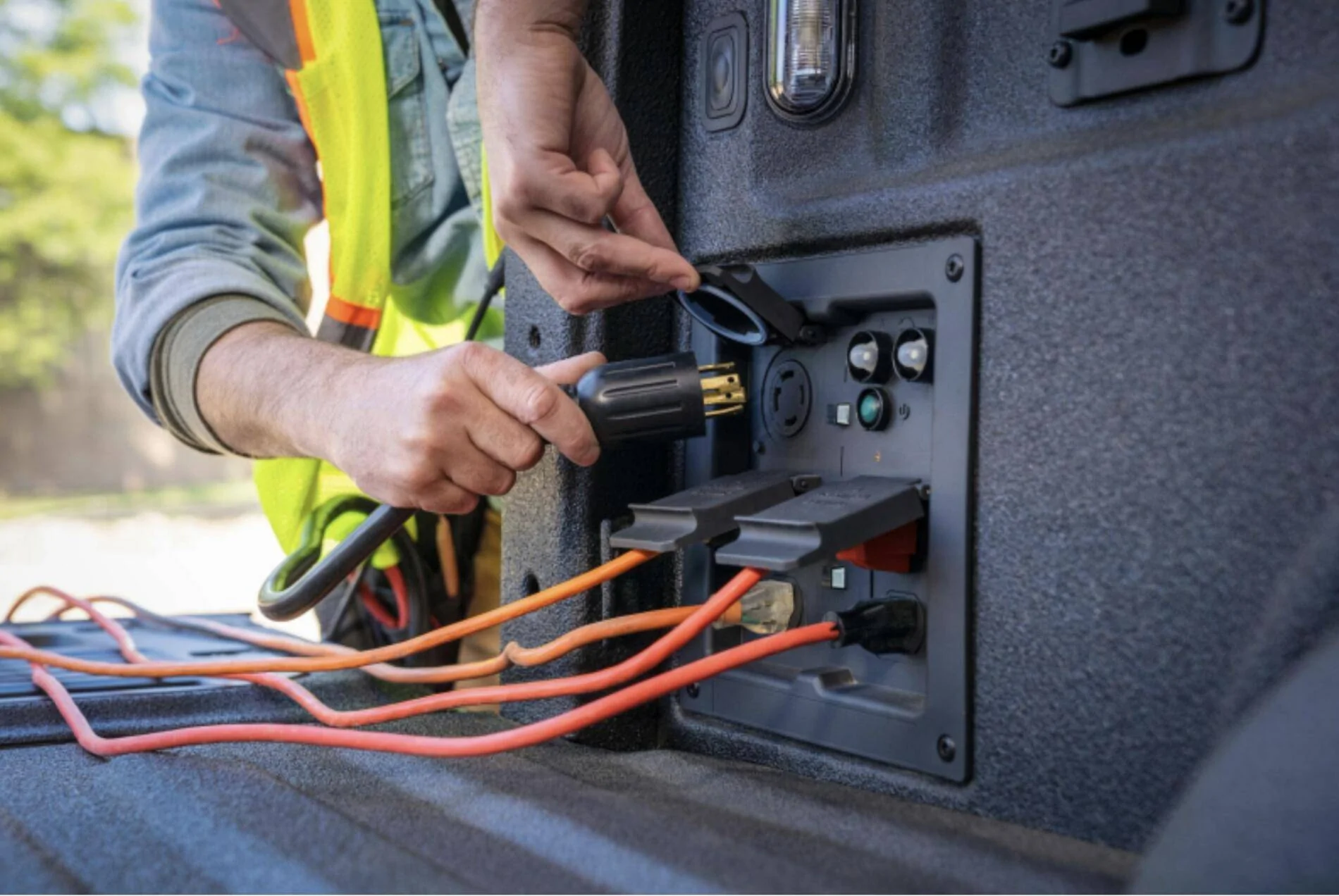

Where do we get the travel adapter? One thing we have lots of up here is F150's. May cost less than a flatbed if you can flag the right truck down ;). In fact I can call a few buddies if close enough. Probably as common as a flat but being prepared is a good thing if it is a $20 adapter.

This seems like it would do it
https://www.amazon.com/Parkworld-885514-Adapter-L6-20P-14-50R/dp/B078X4GK9R
$40 is a little more expensive, but would be super handy if you were ever in that situation and needed the charge from the L6 20 outlet.

That won't work since neither the mobile adapter nor the vehicle will let you limit charging current to 16 amperes.
I have these outlets throughout my garage. My choices for Mach-E were to either buy a 20A EVSE (charging at 16A, 240V), or install a new ≥ 40A circuit for the included mobile EVSE.

Google finger is broken here today ;) but now all here for clarity. That is the new version of EV booster cables and the F150 has it. There has to be someone at this cottage this weekend with a new F150. Problem solved pay for their gas.

Yeah, when they charged the Tesla, they just reduced the charging current from the car. I really hope this ability is in the plan for the MME.

The MME EVSE may be able to charge 12 amps at 240 volts. I’ll try it when I get access.
