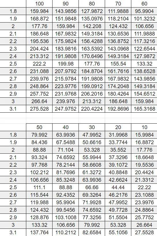

I agree they missed up the GOM. Early on in my Mach E exp. my wife had extreme range anxiety. To ease her concern I created a quick cheat sheet she could reference the stated miles/kilowatt on the sync display and the current battery percentage. This actually eased her concern and we were able to quit referencing it since the GOM had started to predict pretty much the correct range. On long trips we still reference this instead of the GOM to plan our DCFC stops. Now that I am fully updated thanks to Ben's FDRS my GOM consistently displays the range as 247 miles at 90% Then my range takes a nose dive as I get closer to 20%. So back to using the cheat sheet to know how far to go.

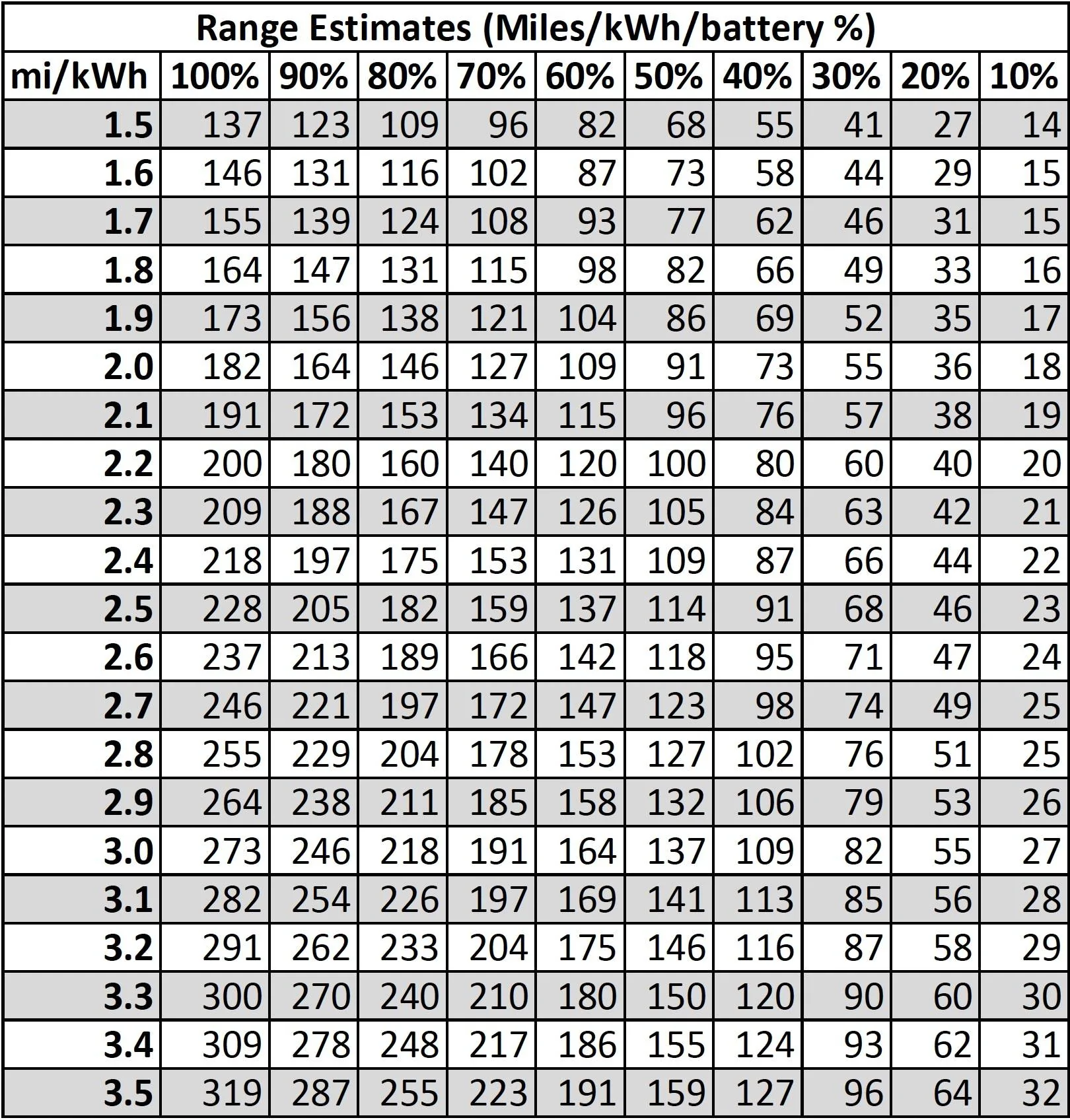

I like this idea and made one for my 2022 GT (91 kWh usable battery capacity). I decided though that I didn't need to four decimal places for the estimated miles ?
Ford Mustang Mach-E Well, Ford, the new "Distance To Empty" algorithm doesn't work . . . Screen Shot 2023-02-07 at 10.45.48 PM
