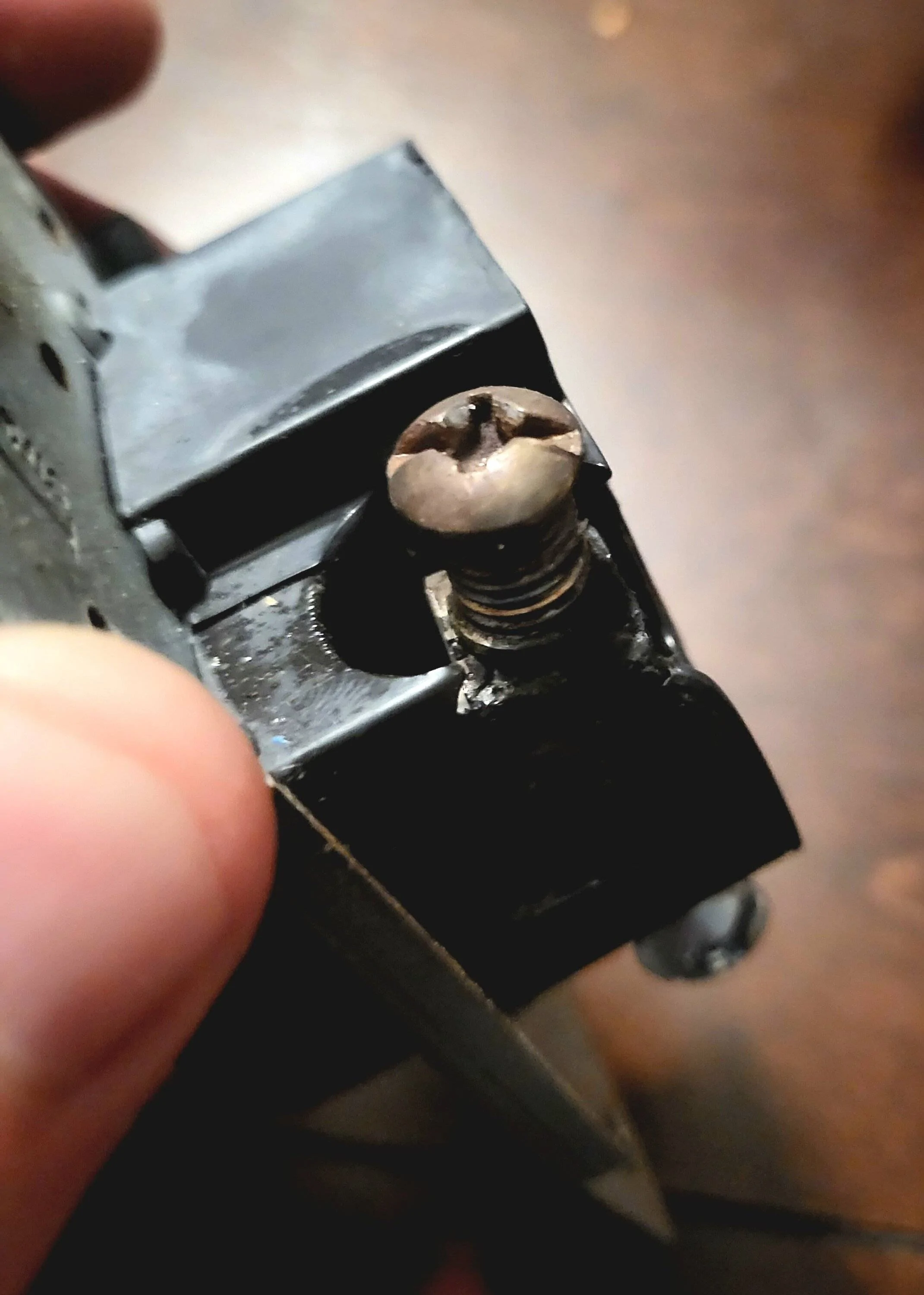

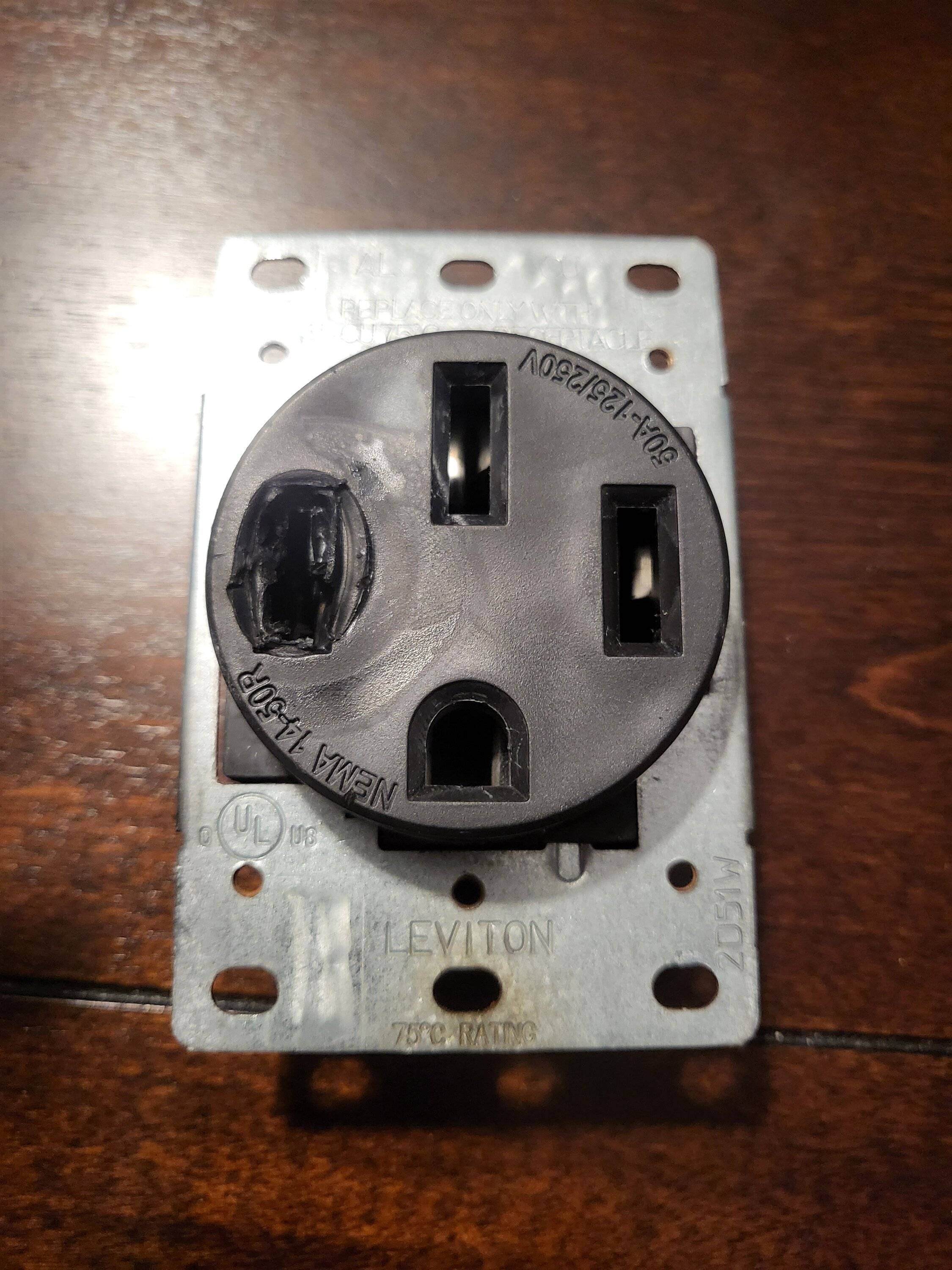

Personally, I've seen too many examples now of melted outlets and just saw Munro's video today as well. Just wasn't worth the risk to me to not buy the industrial grade outlet when I had to get this one replaced.
Edit: Here you go, sorry did not take a clearer photo but this is where it failed.

I'm following code. I think that is part you don't understand. If you follow code none of this will happen.
If you don't know what you are doing or to how to check what your electrician is doing, your $150 outlet will burn just as easily. It is all the same materials, you just pay for more cosmetic visual inspection after the machine scan, that's all.
- Was your wiring landed correctly with code mandated torque.
- Was your insulation kept intact
- Was there no kink or damage on the back end.
- Are you checking your lugs and re-torqueing down the connection every year. Including the circuit breaker.
- Are you doing annual maintenance inspections
Abdication of responsibility causes bad things to happen in you home. Take the time to read what code requires and follow it.
That looks like a wire gauging and install problem. Do you have a picture of the wire and how it was landed.
Sorry no, I took those photos before I got it replaced and chucked the outlet in the trash.
