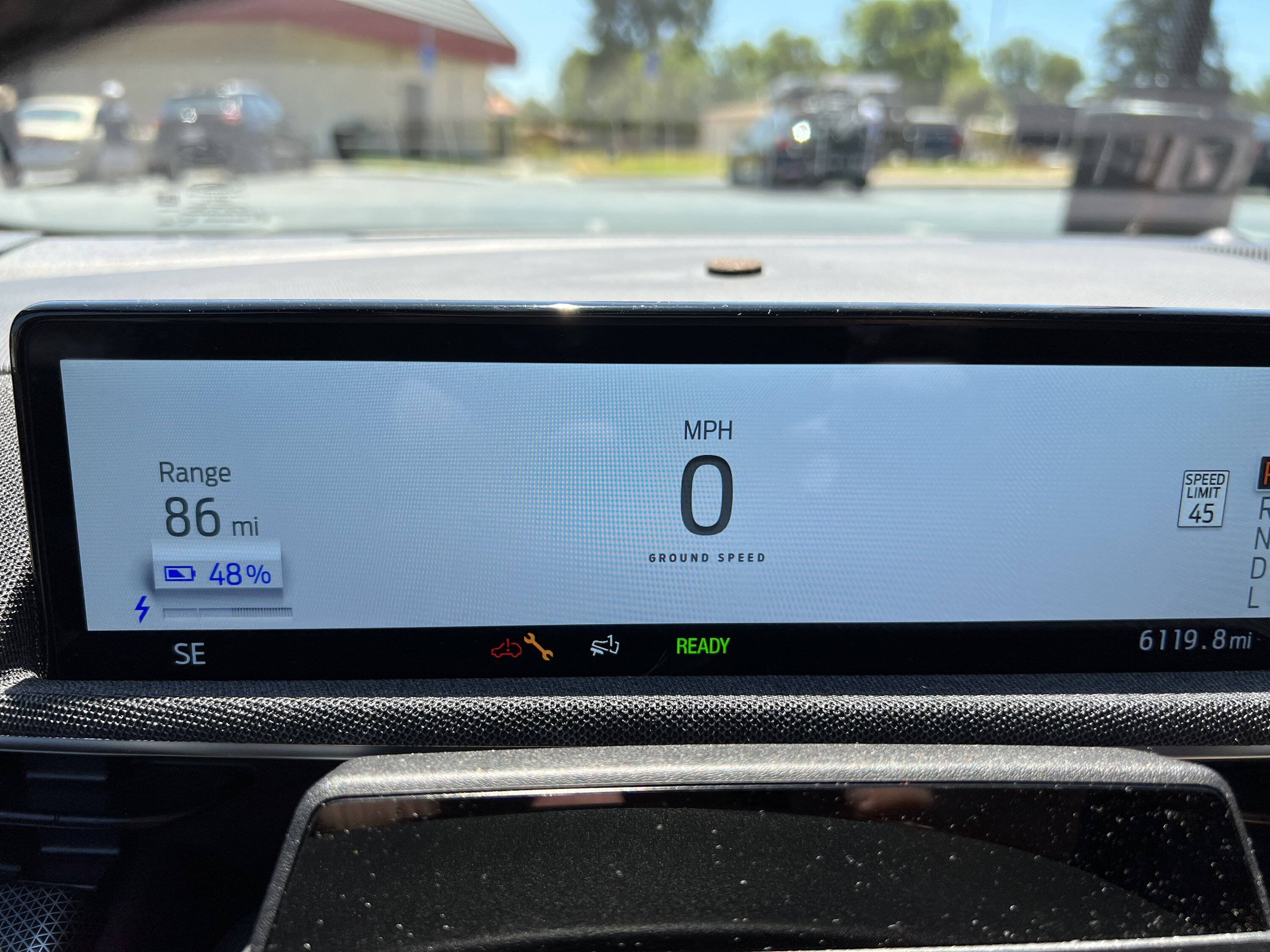

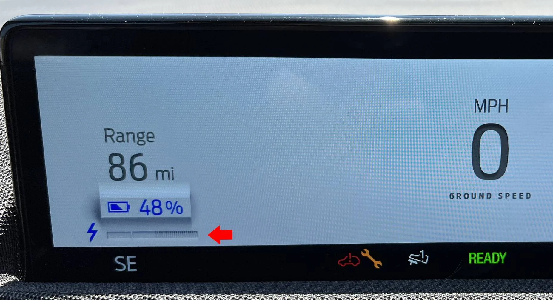

Look on the left bottom here on this photo just below the 48% and next to the blue lightning bolt -- you can see the power bar and the grey "jail bars". As others describe, this is only on GT models unless you do some Forscan hacking.
This photo was taken by me when my car went into "Service Vehicle Soon" mode after the post-recall software detected a problem with the contactors. You'll notice that about 70% of the power is greyed out, and this is one version of what a bad day looks like.
That does seem like a bad day. I saw the gray bars today when driving, and I had a small one even just cruising at 84 mph.
