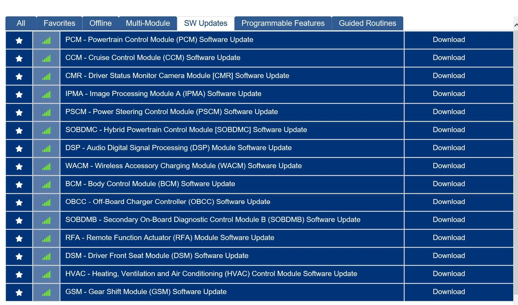

Shayne, are you saying you're car is stuck on Sync version 1.7.1?
I kinda monitor that "stuck on 1.7.1" thread and haven't seen you post there was why I'm asking. If you'd like me to look up your VIN and tell you what modules need updating I can do that. At least you'd know what needs to be done.
Thank you much appreciated. No I am not saying that I have a failed stuck 1.7.1 just stuck. I received 1.7.1 at the beginning of February and that is the status of my updates to date. This only happened as a bit of an appeasement is what I am thinking as I grumbled a bit during a hardware problem and low and behold it comes 2 days later. I Have a pin now at 1.7.1 thanks to @DevSecOps and would very much like to follow what modules are updated as the updates occur. So yes it would be great if I can take you up on your offer at some later date. Here it is at 1.7.1 with a 01500 vin.

Well......for most Job 1 cars...they had the opportunity to have alllll those modules updated via two catch-up programs, CSP 21P22, and 21G01.....
Job 2 cars, although they may already had BlueCruise if they were optioned with the necessary hardware, weren't so fortunate if they were made after September. So there's a pant-load of Job 2's in never-never-update-land that so far have not been able to benefit from those programs.
If you have a Job 1 car and never took it in for those programs and don't have your BlueCruise and improved charge curve that Job 2's never got, or the RFA update, or the updates for all 5 door modules, etc.
You should have.

NOTE IF YOUR VEHICLE HAS CUSTOMER SATISFACTION PROGRAM 22B08 STILL OPEN, YOU NEED TO TAKE YOUR VEHICLE TO YOUR DEALER FOR THE SAFETY RECALL 22S41 SOFTWARE UPDATE.
How can you tell if you have software 22b08
22B08 is not a "software" update. It's a procedure.
Ford are willing to pay a tech at your dealership to perform the steps in the 22B08 program to find out whether or not one or more of the GWM, TCU, or APIM modules are "stuck" and will not update, and then to "unstick" them using procedures in TSB 22-2150 if they are.
