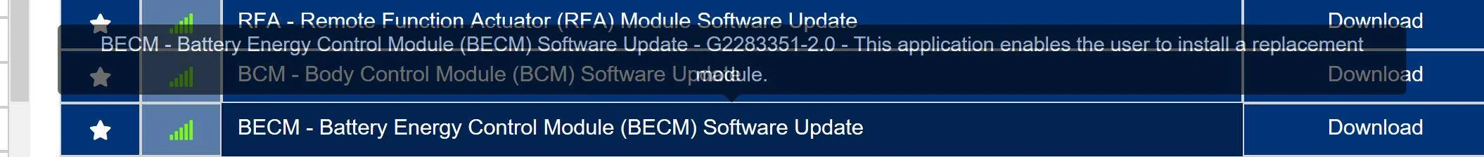

I just ran one of the VINs in the update thread so I'll post it here since it's public already.
3FMTK3SU6MMA50263
The tooltip version for his BECM isn't in the list that Wyld provided. Appears to be newer, but we have no confirmation of the tooltip for the recall correct?
BECM G2283351-2.0
SOBDMB G2225749-5.0
Job2/Electric Motor #5
No, not that I know of.
EDIT: That is the same BECM tooltip for a 24 May 22 build that just came out of the plant and has not had any updates. Currently at rev. NJ98-14C197-BC

I don't have the tooltip versions but looking at this VIN:
BECM : Of course of the recall updates, only BECM did not record the tooltip prefix in the Resource ID history. Prefix is different than on my GTPE so this may have a different prefix depending on model. There are three BECM version prefixes (standard, extended, GT).
SOBDMB: I had G2225749-4.0 in May, this VIN is showing 5.0
SOBDMC: G2186400-3.0 in May, this VIN is offering the same.
My assumption is BECM just has a different prefix (I'll have to start paying attention to this with future updates). All my VINs cleared from FDRS so I'll have to go digging for more. SOBDMB seems to still offer a newer version. SOBDMC is still the May version.

I know this is a really basic question, but what does "tooltip version" mean?
For people who have never used FDRS it's understandable that you wouldn't know.
If you hover over the updates that are pending for the vehicle you'll see a tooltip, which is the black box that describes the update. In that box it gives a version number of the software to be updated. Unfortunately, it doesn't match the module version number. So when we look for version numbers we have to do some cross referencing.
So in other words, we can see what version you have installed, and we can see in a cross referenced way, the version the software wants to install. The numbers just don't match each other. Ford doesn't make it easy for us.
A fictional example would be:
Tooltip version G23423423-5.0 = Software Version DSF-34234-AB
