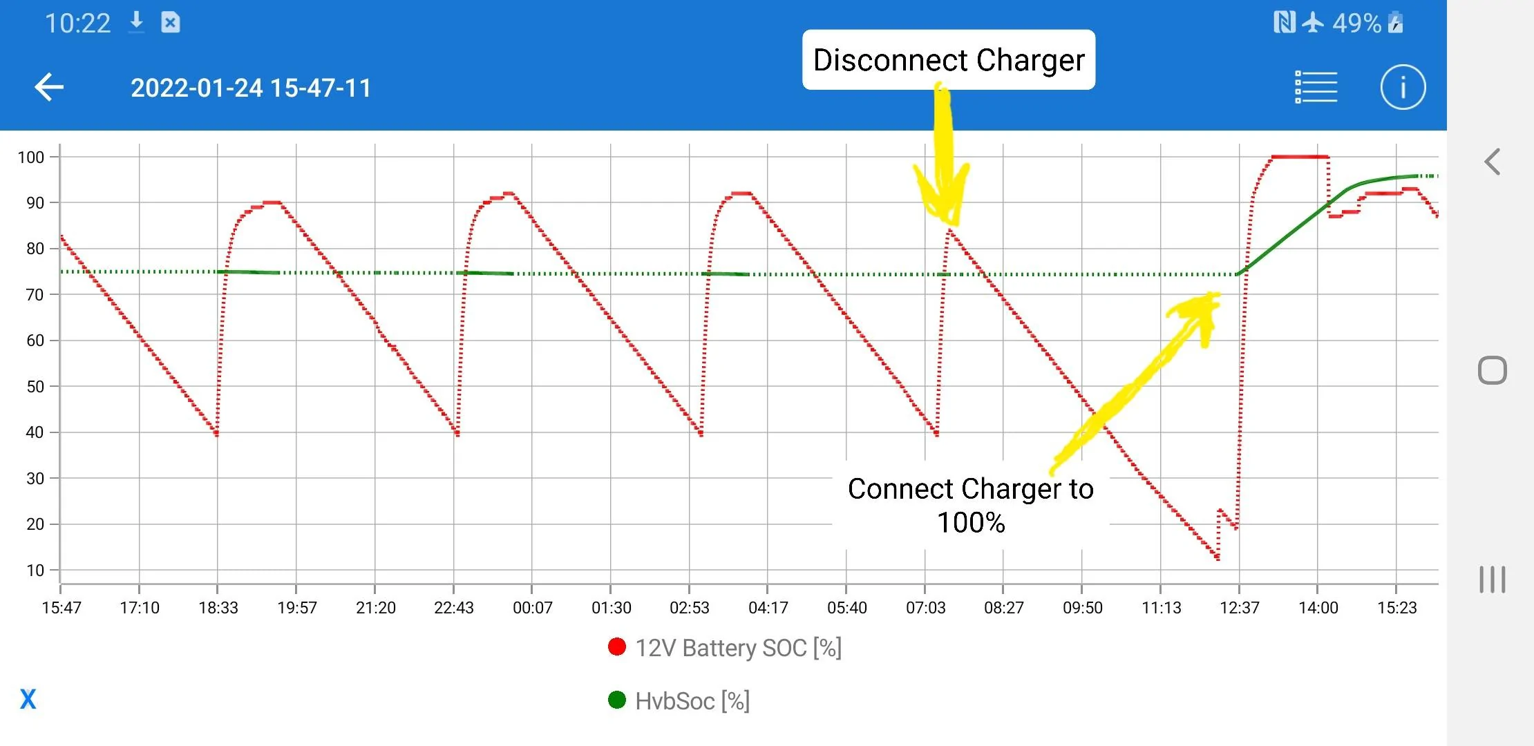

OBDII Scanner. It is fine if I don't have that plugged in.
How do you know it is not doing the same thing if it is not plugged in? If fordpass was draining peoples phone batteries by 50% every 2.5 hours or so like that there would be a 100 page thread about it. The phone battery is also over 10 times less capacity than the 35 ah car battery in the mme. The app running the obd does not drain my phone like it is draining your battery 10+ times it size. Huge draw for a dongle it looks like it drains it in and like a heart beat.

They replaced LVB but it still dies if kept unplugged.
Killing it in 15 to 20 minutes is a whole lot worse than mine I think. But it could be the case here also but it does not happen all the time just at those -28C's on two new batteries. Mine is plugged in when cold. I get charging faults in fordpass in the middle of the night and a time frame to catch it. Thinking the FP message and actual fault are the result of a low 12V and system crash.

Maybe someone here can run your vin for error codes (or OBD2) and provide them to you. Your dealer can see them from afar. I would be interested if the positive HV battery contact is sticking open? Maybe also 12V drain/freeze reaction?
I don't have a measurement to prove it, but I have left my car unplugged a lot longer than it took to drain the LVB down to 10%, and the LVB didn't die. But it is a valid point.
Also, it is not the OBDII scanner that is causing the drain, I don't believe. I have been told that a scanner keeps various components inside the car alive, and that is what is draining the battery.
I will do a test tonight. I will be parking outside unplugged and the temperature is supposed to drop to 26 F overnight. I will not leave the scanner connected. Will report back with what I find.
It comes back on and charges it according to your OBD2 readings so no it should not die. Needs to do that every time it drains 10 iphones in 2 hours while not running much.
Nothing will happen at 26F I think you should be fine unplugged. It has nothing to do with not being plugged in or not I think. I am plugged in and it happens. It has to do with -15F here. A lead acid 12V at 40% soc should freeze when the temperature goes downs to 5F. If it is -15F and sitting at 40% soc one would think it can not be happy. I would think it sees a soc somewhere in between 40 and 90%. You can not let your 12V go to 40% soc up here in the winter. You also can not have a huge drain on the 12V which makes that condition happen over and over again. The fix will be interesting to see.
