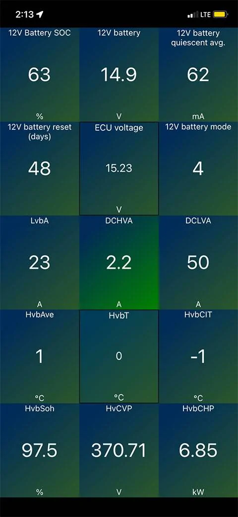

There is a few methods.
  • Measure the voltage across the thermals of the 12V or where you charge it when car off. Makes sense to drill 2" holes thru the frunk cover with 2" plugs for access. Info on this forum and attached.
  • You buy a 12V led that plugs into the 12V. Start it it will jump to 15V charging turn it off open and close the door and it will read the voltage of the battery as you sit. You need to guesstimate a soc. something like this
  • Buy an OBD2 dongle i have a odblink MX+ and carscanner app right now but MX+ is compatible with other apps like forscan etc. It gives voltage soc etc. on dashboards you can mod and set up. Like this.
Is your 12V battery mode always 4 when car is running? Mine is usually 2, then 0 with ignition off (no idea what it really means).
62 mA quiescent standby drain seems a bit high...

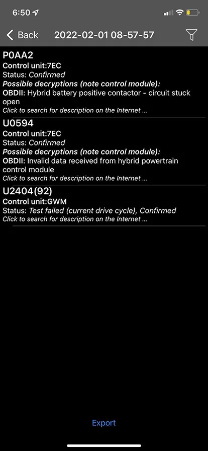

Is your 12V battery mode always 4 when car is running? Mine is usually 2, then 0 with ignition off.
About -16C at that time? I have seen 0 also. I am not too sure what the numbers actually mean. Also not sure the app can be trusted all the time. The charging amps shoot up and then die quick almost like ford DCFC logic. Something not right here and it could be BECM? Here are my last codes from feb 1. Quiescent standby drain was 30 mA that day and mode 0.
