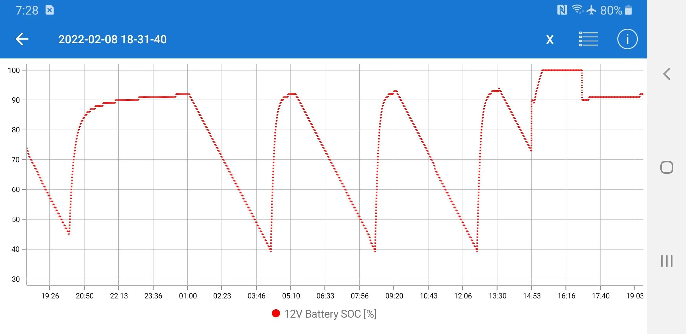

I finally got all my software modules updated on Monday (with an assist from @DevSecOps) and I did the unplug test again - this time when I unplugged there was no noticeable difference with how the car managed the LVB. This is very strong evidence that I had a problem that was solved by the software update, but I only did the previous test one time. It could be there was something weird happening then.
But as others have said, the HVB should maintain the LVB. And it looks like it charges the LVB every time it hits 40% SOC, whether it is plugged in or not. As it should be.
I suggest anyone having this problem do the test I did. Maybe you have some software modules that need to be updated. Maybe. It is an easy fix if that is all that is needed.
Ford Mustang Mach-E DEAD CAR IN WINTER Screenshot_20220209-192833
When I started logging the data above, the car was unplugged. I plugged in and started charging to 100% at 20:00. When it reached 100% at around 12:30 AM, you can see it goes into battery maint mode. At 8:30 AM I unplugged the car. Nothing changed in how the car was maintaining the battery. You can barely see a blip in the graph.
At 14:53 I connected an external 13.7V power supply. That is why the battery charged up to 100%. Which I don't think was correct, because it adjusted back to 90% later, which I think is correct.
This is how it should behave.
BTW - made some edits a few minutes after posting. Sorry if you are quicker than me.

It was in my garage, so not cold at all. I was only measuring if the car would maintain the battery when unplugged, which it didn't seem to do before.
While the dealer said they updated all your modules, maybe they didn't. Have you had someone check your VIN to see if you have any open updates?
If you have the problem @DevSecOps is talking about, updating the modules won't make any difference. I just suggested it since my car seemed to have an issue that could result in a dead LVB prior to the updates. And maybe someone else has the same issue. (I never experienced a low or dead LVB, and the climate in VA is not extreme. I just did a test and saw what looked like an issue.)
