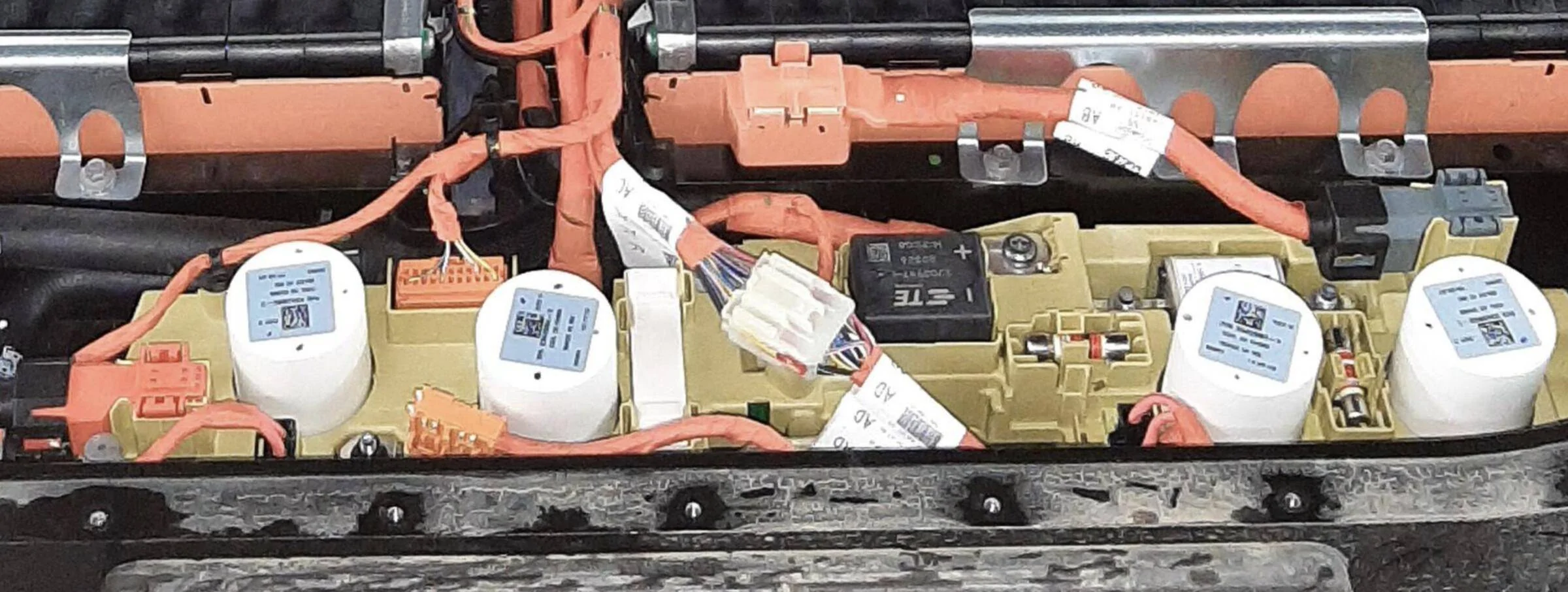

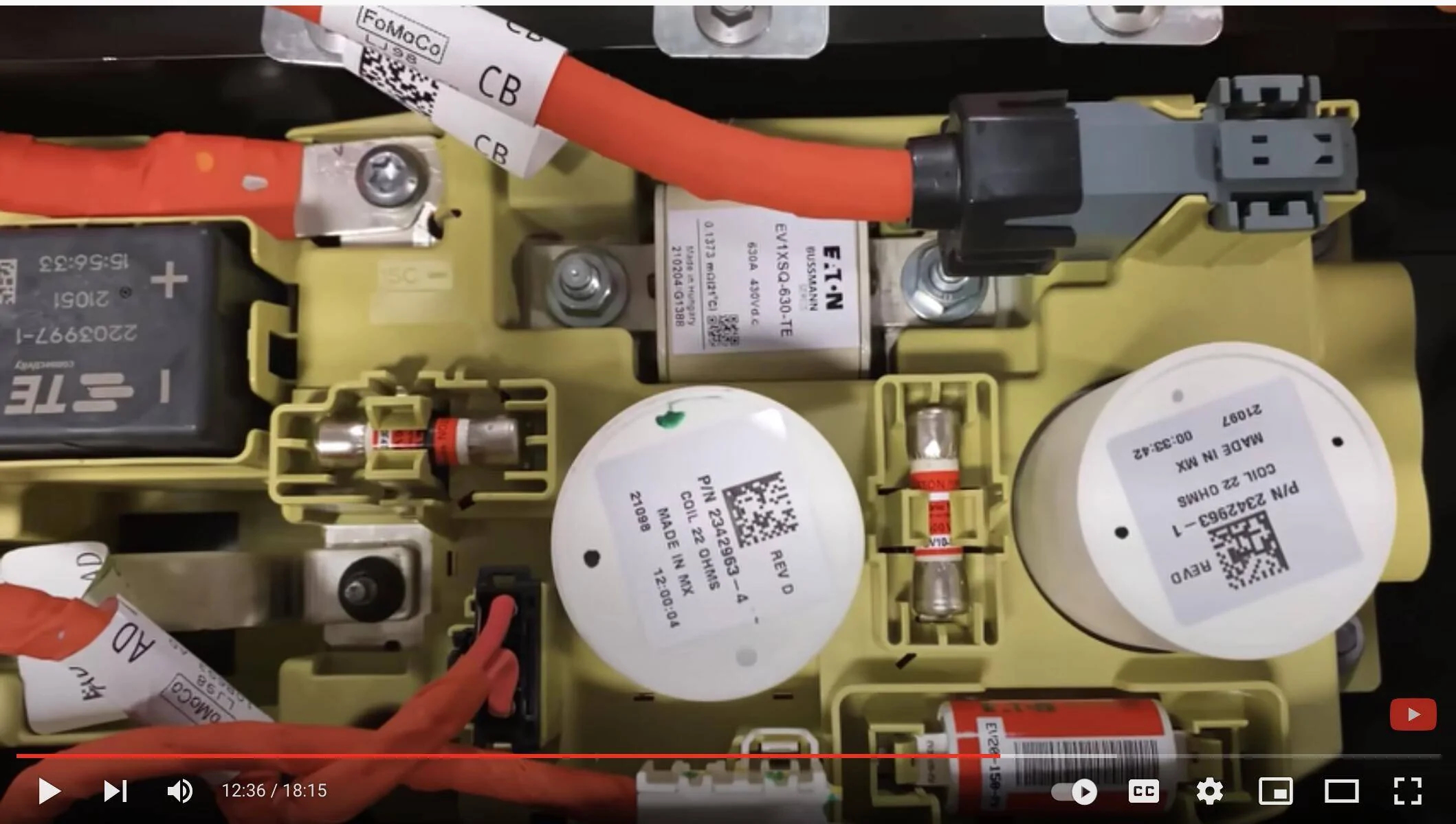

We do not have a lot of information on the hv junction block. There are a number of contactors, and we know that at least four of them (the white cylinders) have a coil resistance of ~22 ohms, and the grey one too.
Not entirely sure how many need to close to charge LVB, MME OFF, no driving. Possibly (?) precharge, V+, Vneg aux to start DC/DC converter unplugged. So, that is about a 1.6 A for three, or 2A if we need four contactor closures.
It is possible that low LVB cold is the cause of not being able to close contactors. But, some MME seem to be working fine in all conditions. It might be some kind of defect in the hv junction block, one or more bad connections/terminations, defective contactors, some loose 12V ground almost anywhere inside the HVB enclosure or out that affects the contactor closures?

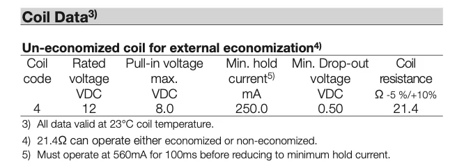

The smaller rectangular grey contactor is the only one I have a data sheet for. It is probably either the precharge (hv resistor) contactor, or the aux negative contactor?
Not entirely sure how many need to close to charge LVB, MME off, no driving. Possibly (?) precharge, V+, Vneg aux to start DC/DC converter unplugged. So, that is about a 1.6 A for three, or 2A if we need four contactor closures.
It is possible that low LVB cold is the cause of not being able to close contactors. But, some MME seem to be working fine in all conditions. It might be some kind of defect in the hv junction block, one or more bad connections/terminations, defective contactors, some loose 12V ground, almost anywhere inside the HVB enclosure or out that affects the contactor closures?
The smaller rectangular grey contactor is the only one I have a data sheet for:

Grey one I see 4 white? Have a high rez of that pic? Couple of substantial old school fuses in there and connectors/junctions. What is the black box (TE) and something to its right behind the 3rd contactor?

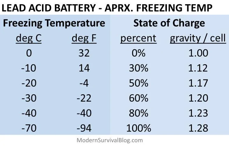

So far for agm not a lot of info to date 12V in general is hard to come by. I have read that the chemical behavior of agm lead acid batteries is similar to flood lead acid batteries and who would expect chemically better? the math What they are better at (robust) is holding a charge and shock resistant (plate support) which helps when you take a tractor into the field/bush. Boats (not mine) etc. I have only seen chemically similar and therefore not more robust. At least I would not assume that in design.
Ford Mustang Mach-E DEAD CAR IN WINTER lead-acid-battery-freezing-temperatur
The math linked above.
Starting it every day and bring/ensuring the 12V is up has worked here so far (3 straight days of below -30C at night it got thru). Trying to save the second 12V for a bit. Above 80% should do it. 40% in my opinion is a no go at -30C. As always if you don't have problems you don't learn as much. You drive it distance every day I would think you will not trigger the problem I can reproduce. Most likely I could take yours and do it to it. More mass with that 50 ah but if nature gives me the conditions I am thinking it is almost a for sure. Too many similar experiences here now for me to think otherwise. I think mine may not be draining it as fast as some (2 problems) and hence mine takes a few days in the cold to get down to a soc that starts to cause the problem.

(The TE box is the fifth contactor with the attached data sheet. The specs say it is good for precharge or aux use, so we do not know how Ford used it yet). There are a lot of connections in that hv junction block, a lot of possible points of intermittent or failure. Maybe they are all good, and the hv junction block failures are a bad fuse or bad contactor, or maybe not. Better picture below. I would love to see one close up, and to take it apart. Nothing affordable on the junk yard sites yet.
That contactor stuck open message complicates the question a bit, but if that message is what you get when the LVB is just too low V to pull in the contacts, even that one, as you have indicated, may well be only a LVB problem.

My HVJB is getting changed out Thursday and I plan to call in the morning and see if they can take pictures for me of the old one before and after removal and the new one before and after install. If I could drive out there and video the whole process for you guys I would. I'll try to get something to post so others can see it better if possible.
