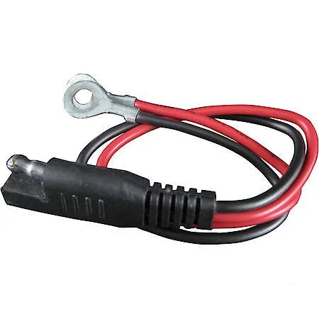

so let me ask you this, would it be possible to put a pigtail wire attached to those two points so that you wouldn't need to remove the panel next time it happened, ie the pigtail would be in the frunk? I'm talking about the kind used with a battery tender type setup. Like this?
I have that setup on all three of my antique cars that don't get driven much. Sounds like my MME will get one, too.
Just like my dads stock model A out the rumple seat ?. Yep if I could get to the 12V easily the small agm high tech computerized charger would be on it in the frunck already. That retrofit should come from Ford if required when this gets worked out. Hope service has good luck popping panels off the frunck. I am not buggering them up for someone to tell me no one told you to do that. Do not have the contacts that Mark seems to have.
