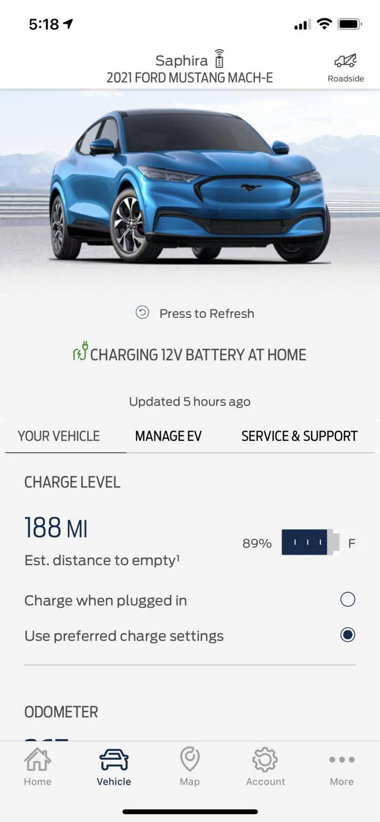

Heard my Mach-E charging when I got home today (hadn’t been driving it) so I quickly checked my FordPass app and saw this:
Ford Mustang Mach-E Deep Sleep Mode - 12v battery drained dead [update: Mach-E jump started] DFF38B92-97CA-43C3-B880-2EB873C5C47C
Makes me feel a bit better

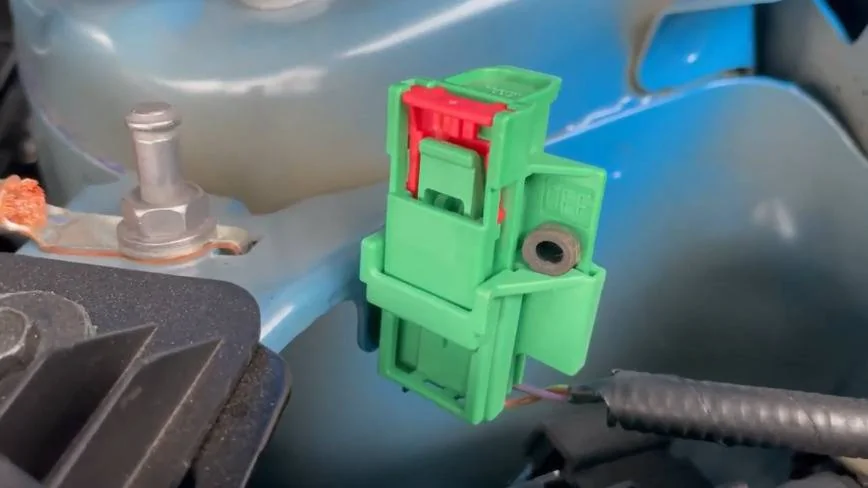

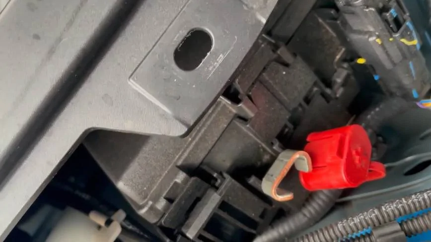

so let me ask you this, would it be possible to put a pigtail wire attached to those two points so that you wouldn't need to remove the panel next time it happened, ie the pigtail would be in the frunk? I'm talking about the kind used with a battery tender type setup. Like this?
I haven't seen it in person yet, only photos. And I'm no expert, so take this all with a grain of salt.
A few thoughts though...
As far as wire gauge, I'd probably just go by whatever 12V car charger or jumper battery you plan to use. Those things have their own charger cords and should be sized right for the amperage delivered. Never hurts to go thicker, of course.
As far as securing the hot (+) terminal in the car, there's no hole on the terminal, so you'd need to figure out a good, secure fitting for it that would stay in place if you plan to leave it connected all the time. Also, it's covered with a rubber sleeve for a reason - it's a hot terminal. So I'd be sure that the insulator sleeve fits back on, or you insulate it another way. (Same with the other end of your wire you leave hanging in the frunk.)
The (-) terminal looks like it just grounds to the chassis like any other car. I'm not sure whether you need a wire directly to that, or if you can just clamp onto the frunk hinge or other frame metal for a trickle charge. That might be sufficient. (?)
Here's something I have no idea about but should be researched: there's a high voltage disconnect. I don't know if that needs to be disconnected before doing a trickle charge. No idea, but research it first.

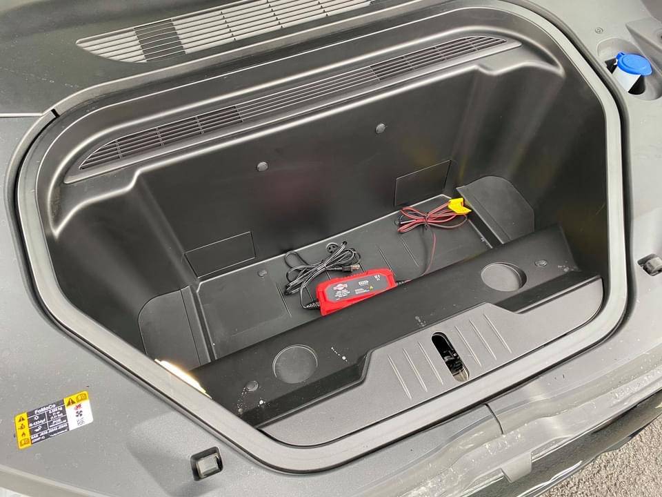

Yes--it appears the wire is thin enough
I have this running from the from jumper points on my Ford CMax Energi thru the front grille so I can trickle charge it every night.
