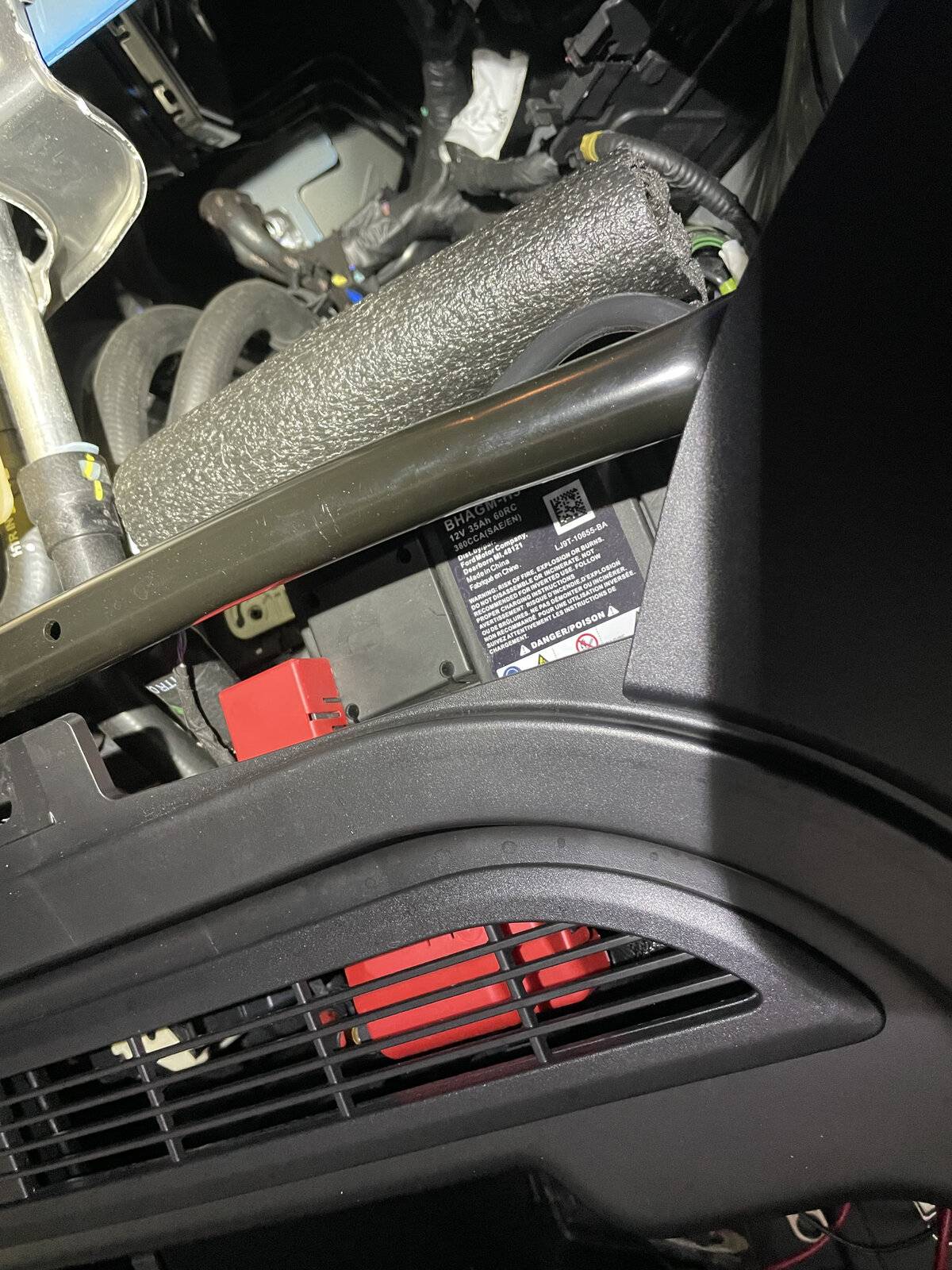

The poster of the following video replied in the comment section that it only works when the LVB is dead:
Glad I saw the video posted here! Removing the rear panel to directly access the battery looks to be WAY easier than removing the left (driver) side panel!
