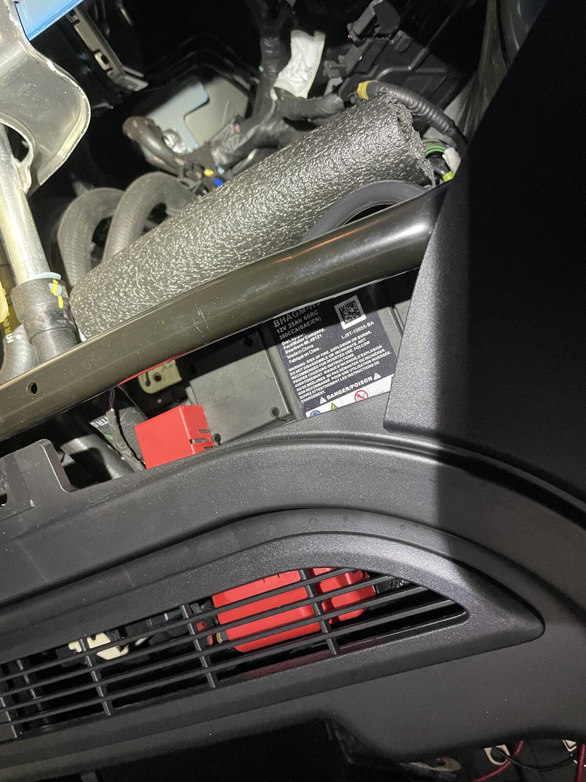

Anyone that has removed covers and recharged their battery, was it a deep cycle or short cycle high amp battery?
AGM starter battery. It lists voltage, amp hours, and CCA. Sorry, Marlin is in the shop or I'd take a picture for you.
Update, I had a photo of my battery on hand:

I think one of this would probably have been effective at bringing Marlin's LVB back up to the point where I could start him. I used a trickle charger. I didn't jump Marlin because I was fighting with issues of ice covering my other two vehicles:
