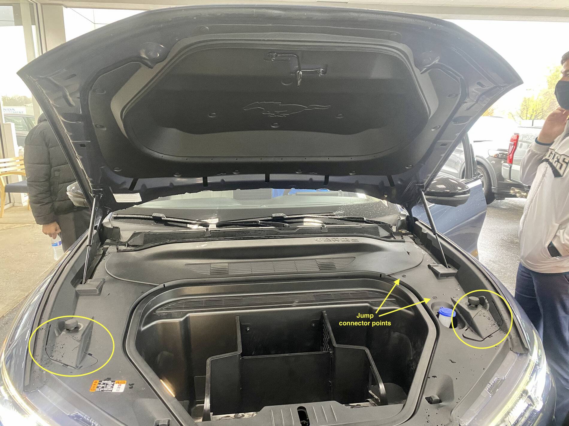

So how hard is it to take off the frunk cover? Just seem like a cut out for the terminals would have made life a lot simpler. Less pleasing but more functional.
It's a pain, especially in the dark at 25°.
As I said, they already have those panels at the back of the headlights. They really should have 1 large or 2 small access panels to reach the jump connectors.
