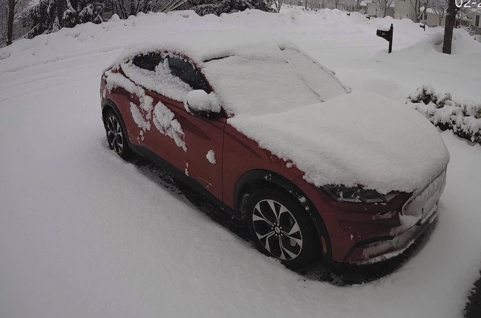

Yup, my errors appear to center around DCFC, I am being patient while Ford engineering is working on it. Another day of snow here in NJ, not like I would be going touring. Weather folks said zero accumulation today, not sure I agree.
Demo MME is sitting in the cold after going to my work place and coming home in the snow.... However this MME has been flawless, did get one SYNC4 issue today, while driving the Nav hung when I tried to bring it up. Left the car and came to go home, it came up normally.
And...how does it do in a snow covered parking lot? Video proof is needed.
