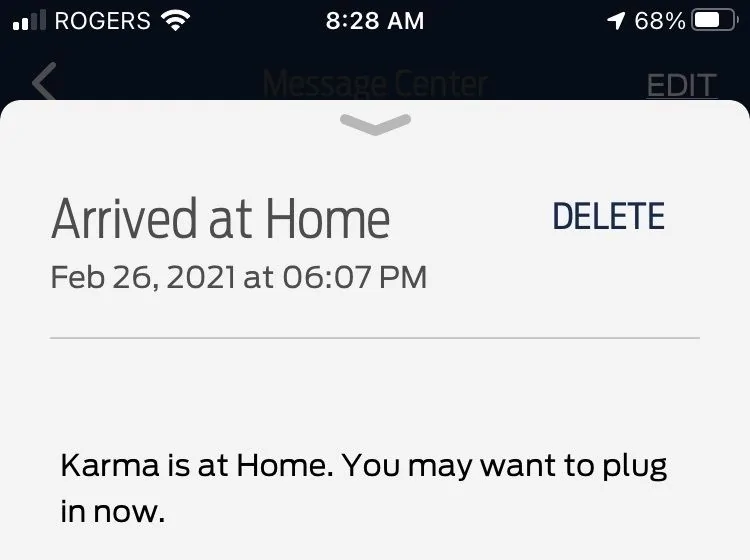

I have installed phone as a key on two phones twice to set the Schule up via fob. This was my original problem prior to the the 12V crashing at not a good time -27C (-17F). Not sure how more low level than that I can get. I did do the vol arrow and reset sync for the first time last night did not help in that combination. First I set it up in the app didn't work. So deleted it from saved locations thinking it would still be in previous (with warning messages about deleting it from there) but it is not. I did @JamieGeek suggestion and went and charged elsewhere (DCFC tested and it worked but @ 30KW at a free one) came back and home repopulated into previous locations. Right now deleting it may still incurs moving it 90 Km. Who wants to volunteer to delete one of there saved charging schedules and see if it copies it back to previous or it is just gone ;).
Came back 46% 200 km yesterday. Got this message.
Ford Mustang Mach-E Deep Sleep Mode - 12v battery drained dead [update: Mach-E jump started] Screenshot 2021-02-27 at 8.28.04 AM - Copy
Think it knows it is at charging schedule home? Fordpass has not updated since I unplugged it 10 hours ago at 63% before I went to bed. It is hard to test a charging schedule when the vehicle is charged to 100%. All good just need the charging schedule to work. The vehicle runs great. I always learn things the hard way but understand them at the end. If I set phone as a key and link it to a profile for the third time I should have it down pat.
