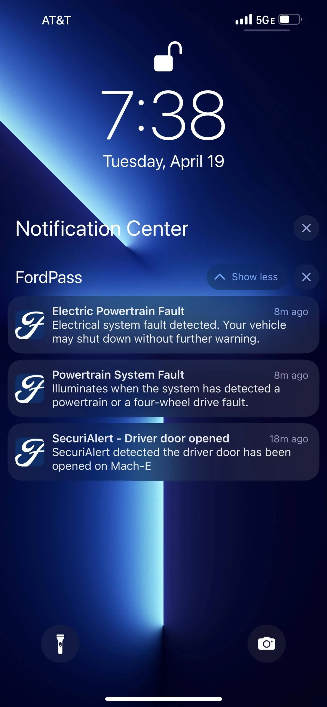

I don't think that type of warning is a problem as they update certain modules.
My driver's door opened yesterday at 3:25PM, and this morning at 10:20AM. Wonder what they were doing from 8AM to 10:20AM?

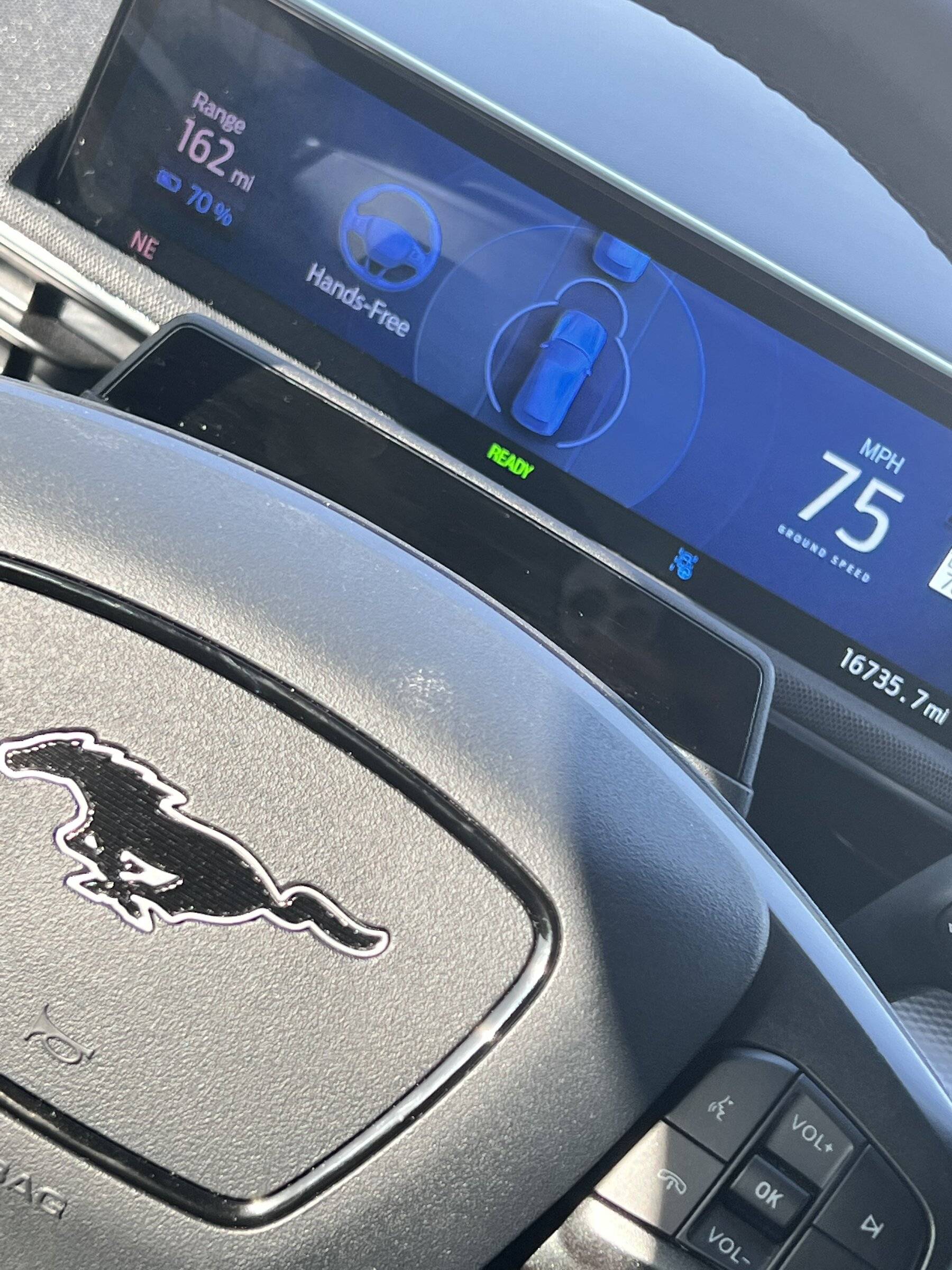

Hi @benk016
I'm glad the new FDRS is solving the APIM issue. My dealer had managed to get me up to Sync 364, so my APIM updated. All of my ACC and LC are working fine, LC with Hands-Free is turned on, I have the October expiration date for my maps, and I get the BlueCruise "box" on the screen. However, I still haven't received BlueCruise in Connected Services and the people at FordPass tell me I have to take it back to my dealer.
I really don't want to waste the dealer's time or mine if the dealer won't be able to fix it. Do you think the dealer will be able to fix it now? Is there something they'll be able to do to get the FordPass initiation moving?
