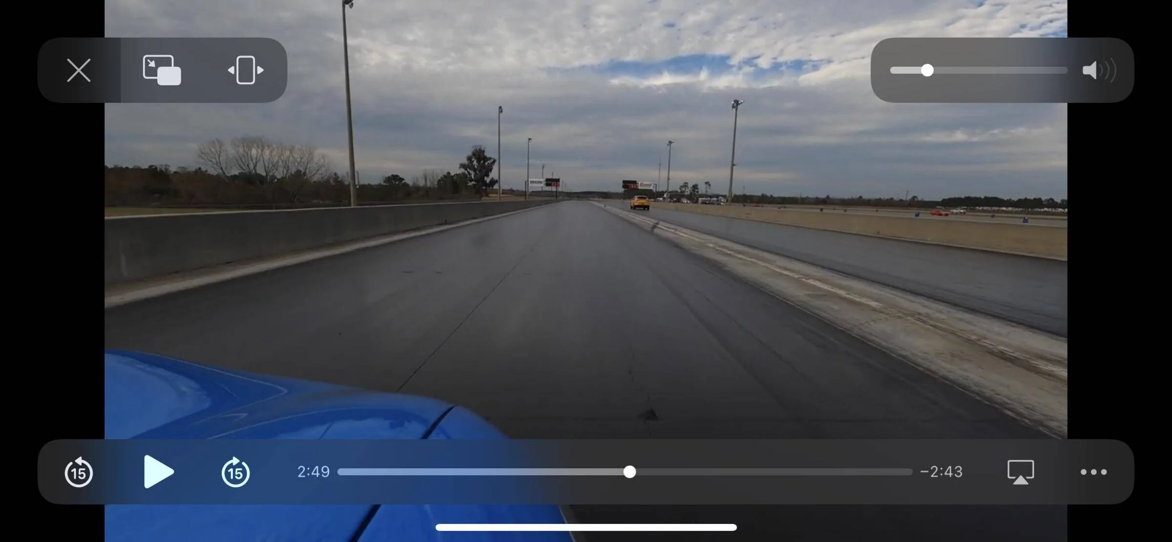

In Florida today was the first time I’ve had bars upon startup (one bar and it was in the low 40s this morning, no preconditioning).
Without the bars, the GT is so much faster it’s silly. Check out the video posted today. The GT pulls like 6 car lengths by 80 mph.
https://www.macheforum.com/site/thr...o-head-drag-raced-why-because-race-car.14013/
See that little orange car in the distance? Yeah it was racing a 1st edition from a dig (4X ER).

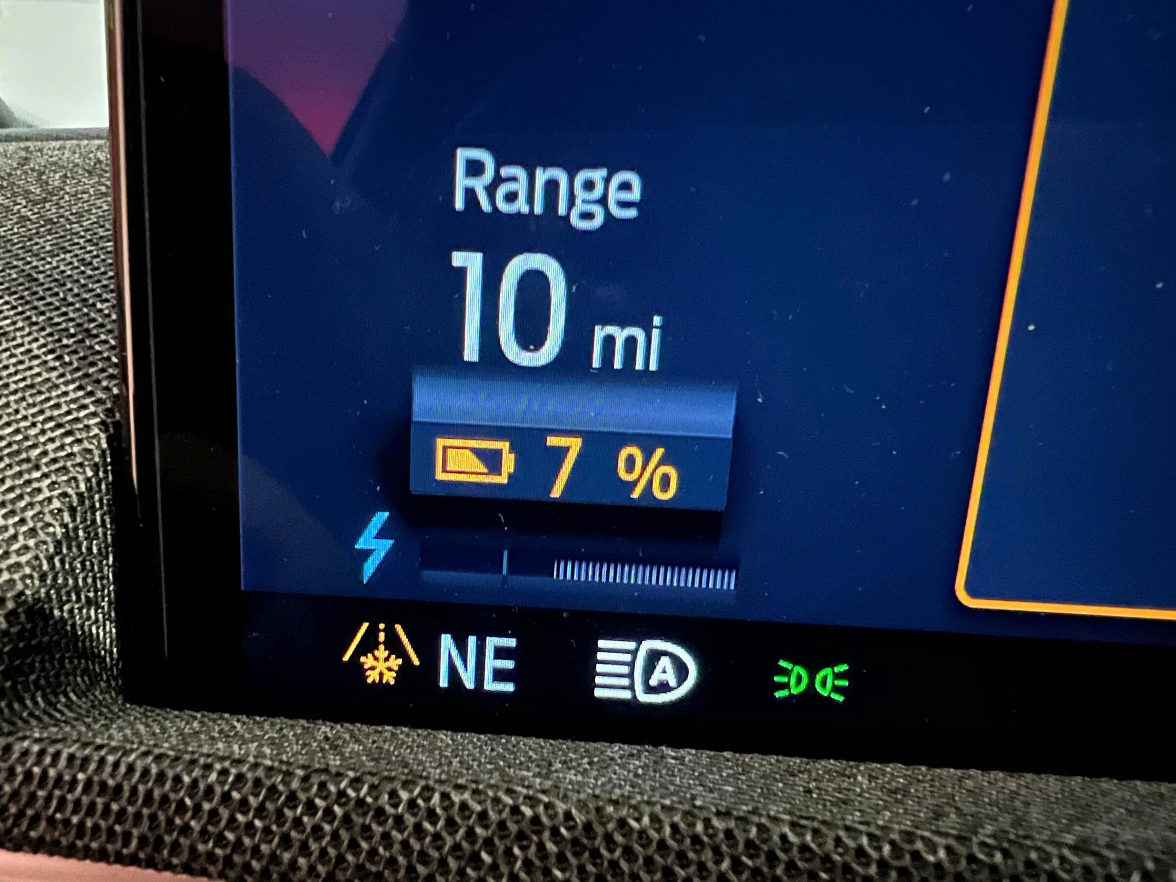

Here's the worst I've seen. 26 bars. Was about 20ĀŗF I think and very low SoC. I made it home right when I took that pic. The car was SOOOO slow.
so..... what do you expect when the HV is at 7% ? The MME is just trying to get you to the next charger as efficiently as possible... which is SLLLLOOOOOOWLY

I didn't expect anything more. Just showing what I saw. I don't think it is about efficiency though I think it is HVB temp being low making it limit current to keep the voltages from dropping too low.

yup, the combination of low SOC and low temp is a killer since the battery loop heater cuts out when HV SOC falls below.... 15% I think? as battery core temp drops, voltage drop under load would get worse, combined with the voltage drop that naturally occurs below about 15% SOC with lithium batteries.

I think it is important to note that the "regular" non-GT models are doing something similar in those circumstances. There is just no gauge to show you.
