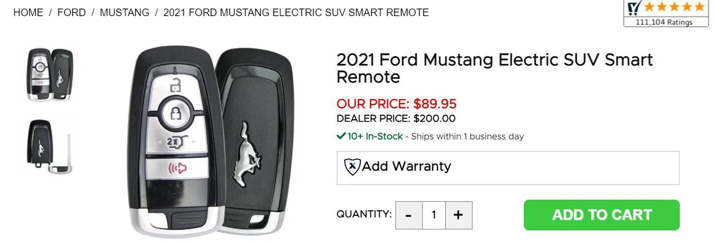

I have a 2020 mustang key w/remote start button I'm going to attempt program to the car. I have a sneaking suspicion the remote start button will actually remote start the car. I have no idea why Ford didn't put the remote start button on the key but for whatever reason they didn't.
I have to meet up with my buddy that works at Ford so he can program it...hopefully next week.
One note...according to the website you guys are buying from this key's part number is from 2018. That makes me think it is no different than any other Ford key. Nothing special about it. I looked it up in HVBOM and sure enough...2018 model year part number for the key. Just a 2018 mustang manual trans key.

Thanks for the tip. I ordered a couple. Contacted local locksmith who says he would charge $80 to program one or $100 to program two. He said he is not positive he can do it since it would be his first Mach-E but won't charge unless he succeeds. By the way, I did get the 10% discount from Car and Truck Remotes. They are scheduled to arrive March 4.
My fobs arrived today. They appear identical to the one that came with the car including same part# sticker. Locksmith is coming tomorrow or the next day. Will report back if he is able to do the work or if I need to go to the dealer.

Ordered mine for $89.99 from https://www.carandtruckremotes.com/2021-ford-mustang-electric-smart-remote-4b.html where they say they have more than 10 left. During checkout, was offered 10% discount to be automatically applied at checkout if completed within 10 minutes, but it was not, so I have sent a message to their customer support. Hoping to program it myself.
Thanks for the link! Mine arrived today, same part number and everything. That little printed code you see when you remove the blank is actually 15K601-FA on mine (like the original fob someone posted,) whatever that means.

Local auto locksmith just completed the programming for my two new key fobs. They work perfectly. He charges $80 to do one or $100 to do two. It took him a while to figure it out because he had to use the Ford OEM box and his computer to do the programming. His usual key programmers would not do the trick. And, with the Ford OEM stuff, he had to do a couple of software updates and a firmware update of of the OEM box. The next Mach-E fobs he programs will probably take 10 minutes but he invested a lot of time with mine. He felt it was worth his time and appreciated that I let him learn on mine.

Added identical Ford original fobs so no remote start. Let's hope Ford OTA enables it with a key press sequence (I am not holding my breath).
