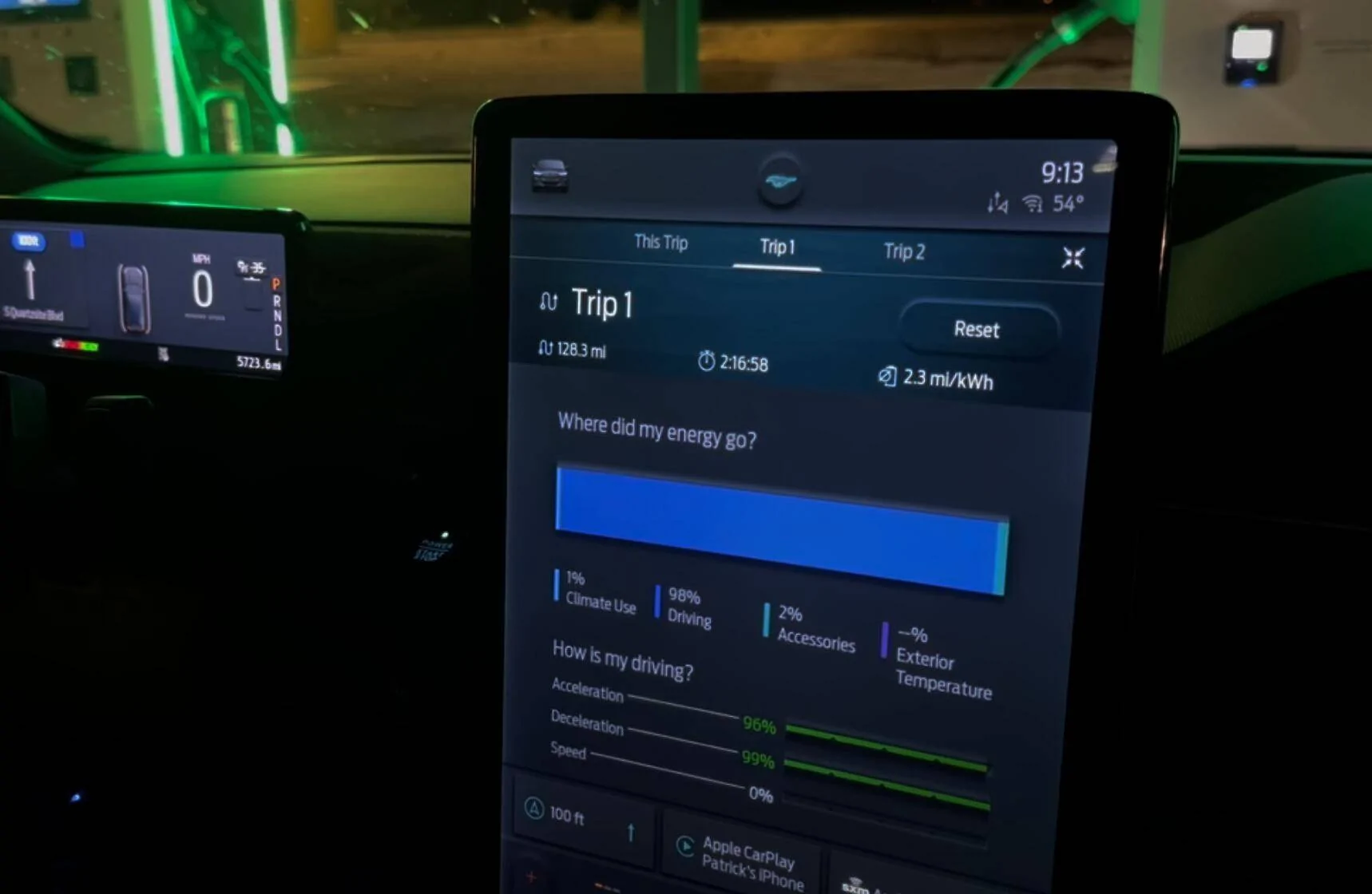

I can get the EPA range or more in my Mach-E doing normal driving -- lots of suburban highway with city driving as well. But on long road trips, 2.4 mi per kWh is more likely and less in the winter (and now that we have a GT).
We did the opposite of your trip back in November. From Glendale to Quartzsite, we got 2.3 miles per kWh. That would be about 209 miles on full 100 - 0 percent run. That was also doing 75 to 80. If I dropped my speed to 70, it would have jumped up in efficiency. Check out InsideEVs 70mph range test: https://insideevs.com/reviews/520484/mustang-mach-e-range-test/
Over time, I have found the GOM to be fairly accurate unless A) speeds change suddenly (lots of city driving and then we go on a road trip), B) temps drop (or other weather changes), or C) terrain changes drastically (like heading into the Rockies).
Here's a screenshot from the car after we pulled into the charging station in Quartzsite (from a road trip video we haven't even edited yet).
