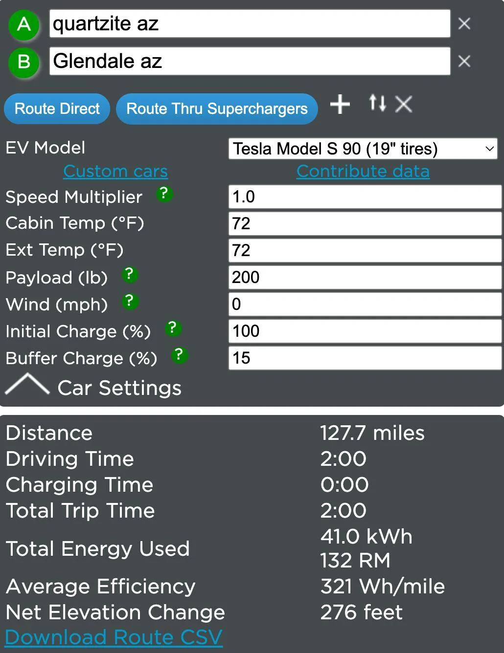

Ford Mustang Mach-E Terrible Highway mileage! Screenshot 2023-02-08 at 9.39.01 AM
Sorry I had to use a Tesla to get elevation change. I thought ABRP showed elevation but maybe only in the phone app. 1.0 speed is going the posted speed limits. This trip was all down to your freeway speed not elevation.
