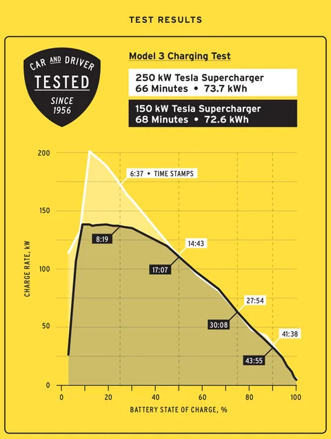

The Tesla Model 3/Y takes ~28 minutes to charge to 80% on V3 and ~30 minutes on V2
Slight correction... those appear to be the 75% SOC points on the chart, not 80%.
Plus, it appears they started from about 3% SOC, which it unrealistic. Most people won't plan to go below 10%. Although maybe that's just they way the chart makes it look.

It's a combination of hardware and software. They always engineer some margin in the limits so it's a safety decision on whether to unlock that or not.
150 kW vs 250 kW really isn't the point so much as how long it takes to charge. The Tesla Model 3/Y takes ~28 minutes to charge to 80% on V3 and ~30 minutes on V2 (can be 3-5mins faster or slower on either, depending on conditions). Where 250 kW really shines Is that first 40-50% state of charge that can be regained in 12 to 15 minutes.
The advantage is really only for < 50% SOC. From 50% up it's nearly a flat difference of 2 minutes. While that can matter for a splash and dash, if you're charging 10-80%, the time improvement is only 6%.

I'm not sure how C&D did that testing, but here's a clip from Tom Moloughney that shows his M3 hitting 250kw at 5% and staying there until 24%. It kept over 200 kw up until 30% SOC, which granted IS after 4:00 minutes from 10% SOC (6:31-2:34). It also clearly shows the 10% to 80% time as being under 26 minutes (28:04 - 2:34):
I also didn't read all of this, but what one also has to consider: the MME will also have a similarly shaped graph. The ER will taper off from 150kw down to 110 or so very quickly, just like the tesla drops from 200+ to 150 quickly. The SR at 115kw starting point will take longer to get the same amount of energy as the ER, even though the 10%-80% is faster (because it holds less).
After all is said and done, the MME charge time to go from 10%-80% WILL be longer than if it started at 250kw. DCFC charging on the ER MME will also be significantly more expensive than the Tesla AND almost any ICE.
So according to him, 0-80% in 28 minutes. Ford says the MME will go from 10-80% in 45 minutes. That is a significant difference when on a trip.
Absolutely, although this is for the model 3 LR (75-ish kwh battery); the Model Y will be a little longer (95-ish kwh). Also it isn't likely on a trip you'll want to risk going down to zero - but the 0%-10% is only a couple of minutes so it's practically the same.
