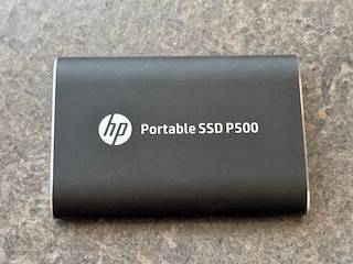

Martin, mine is similar to yours (500GB) which like you said is overkill but I use this little SSD for many other things besides FDRS. I think I only used a USB stick for 2 or 3 updates before I got fed up with the slow speed and that was about 2 years ago.

And KUDOS to HuntingPudel. Following his advice, I installed this with my new USB-C external m.2 SSD. Wayyyy faster although (of course) the SSD capacity is overkill for this use. I got it on sale at MicroCenter for $49 + tax. SO worth it for all the FDRS updates which need a USB.
I bought a cheap lightly used 256Gb NVME SSD on eBay and a external USB-C housing, total about $35 including tax. Now I just need all the BC 1.3 modules to show up in FDRS?
Does it have to be wiped or can you have other files on it? I have an external SSD but thought it had to be wiped.
I quick-format mine every time just like the USB drive I formerly used. exFat format.
I've never tried with files on it. Like Martin, I do a quick format before using it for FDRS.
