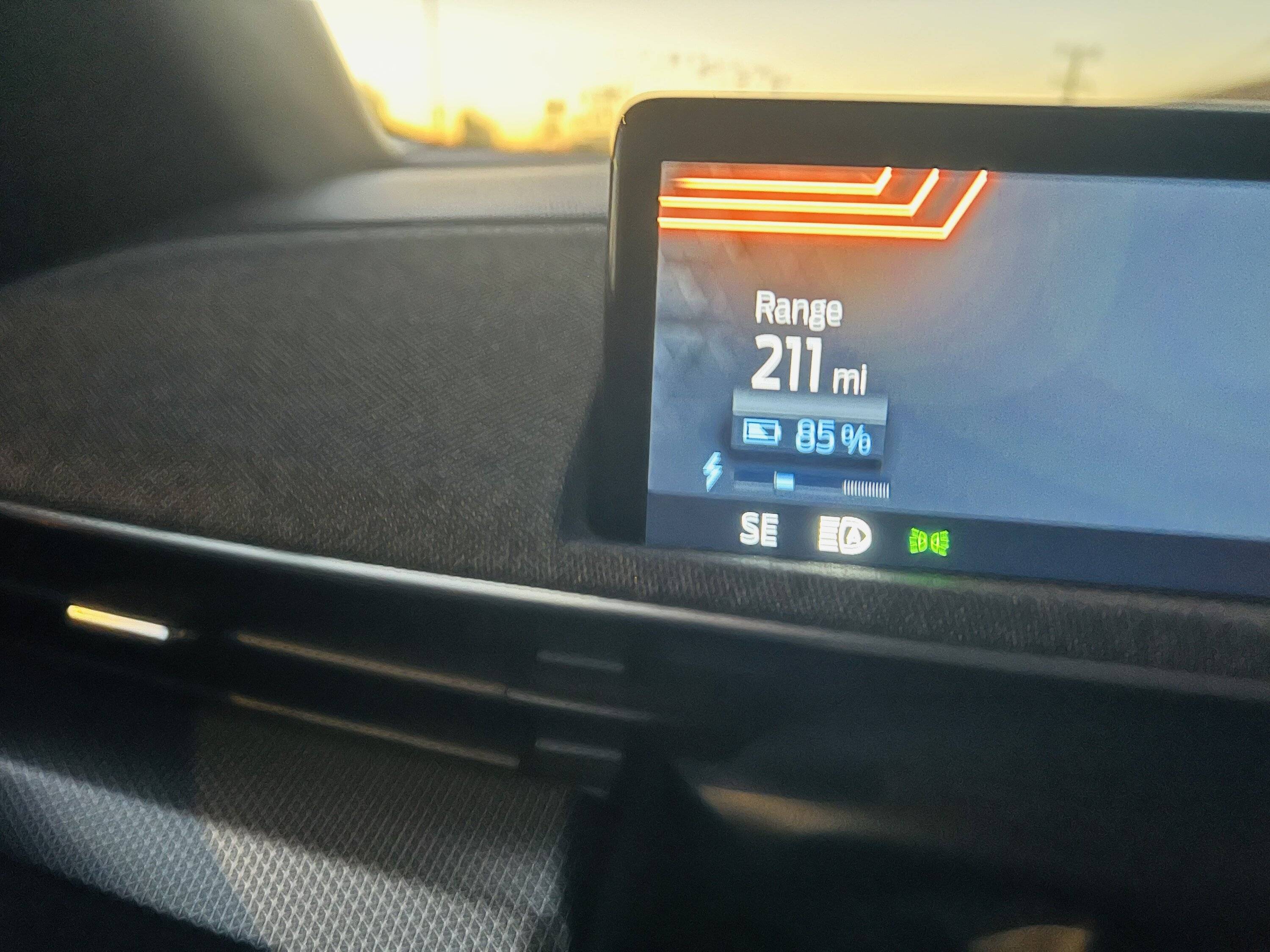

My car woke up this morning with a zero second limit after L2 charging to 85%:
These are the quantity of bars you see after going WOT (note that I did not go WOT this morning and the bars were present at 15 mph). The 72 mph singular bar is speed triggered (with more bars appearing as speed increases, and bars disappearing as speed decreases). The WOT bars are different all together. There are several things going on here that affect the bars on the display. Mine currently are not related to speed or power over time, but I have no DTCs. Gonna pull the 12V power after I get home from work if a key cycle doesn’t clear this (TCU doesn’t seem to be talking to Ford since yesterday morning). ?‍♂?
A key cycle or maybe time did it. I remote started just before leaving work and got deluged with notifications from the FordPass app, plus no more jail bars. No clue why the car was constipated. ?‍♂?

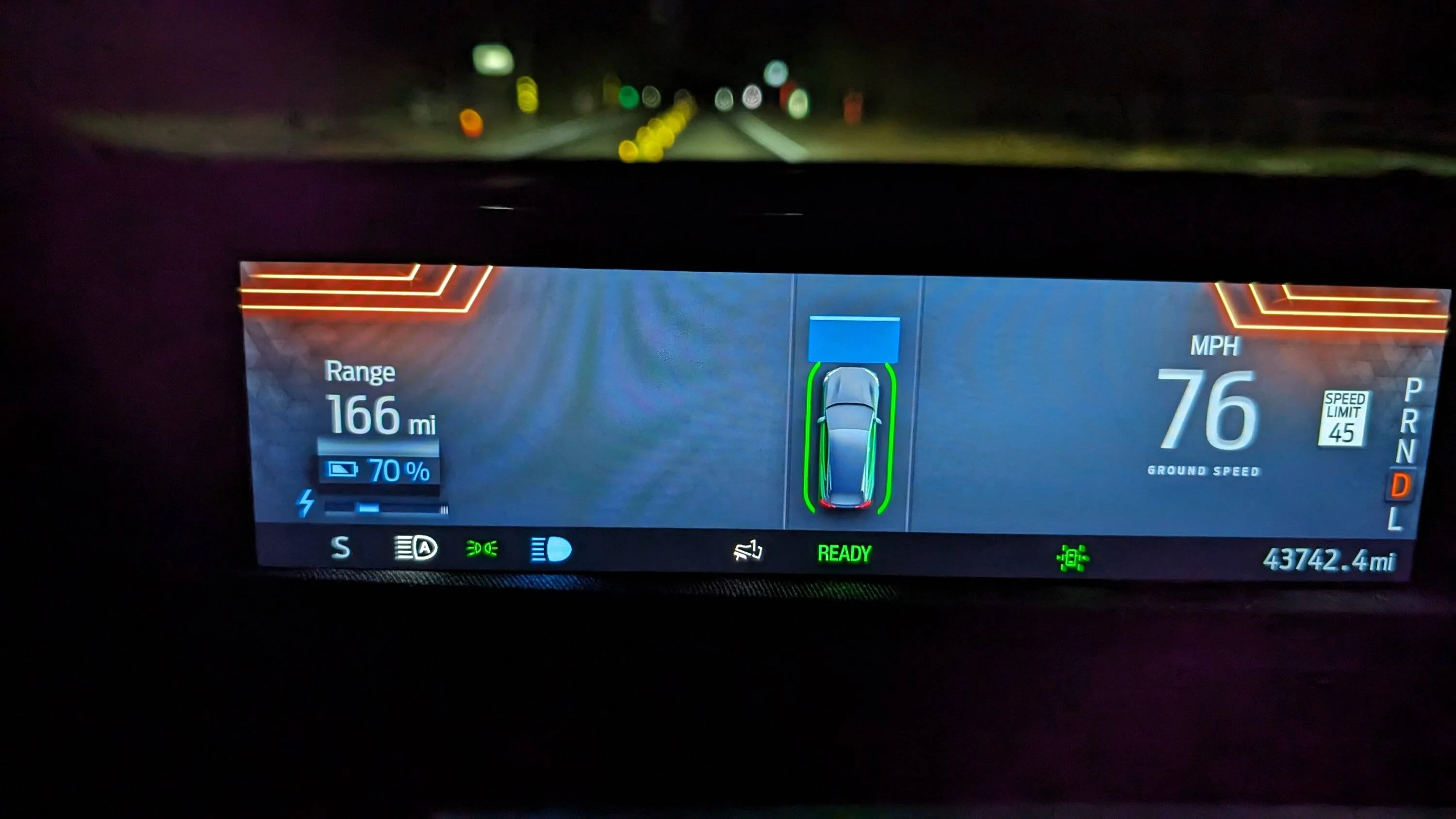

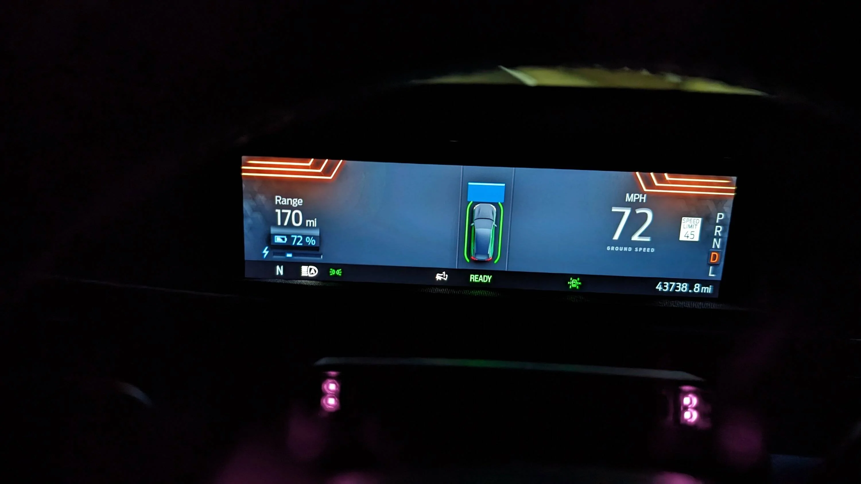

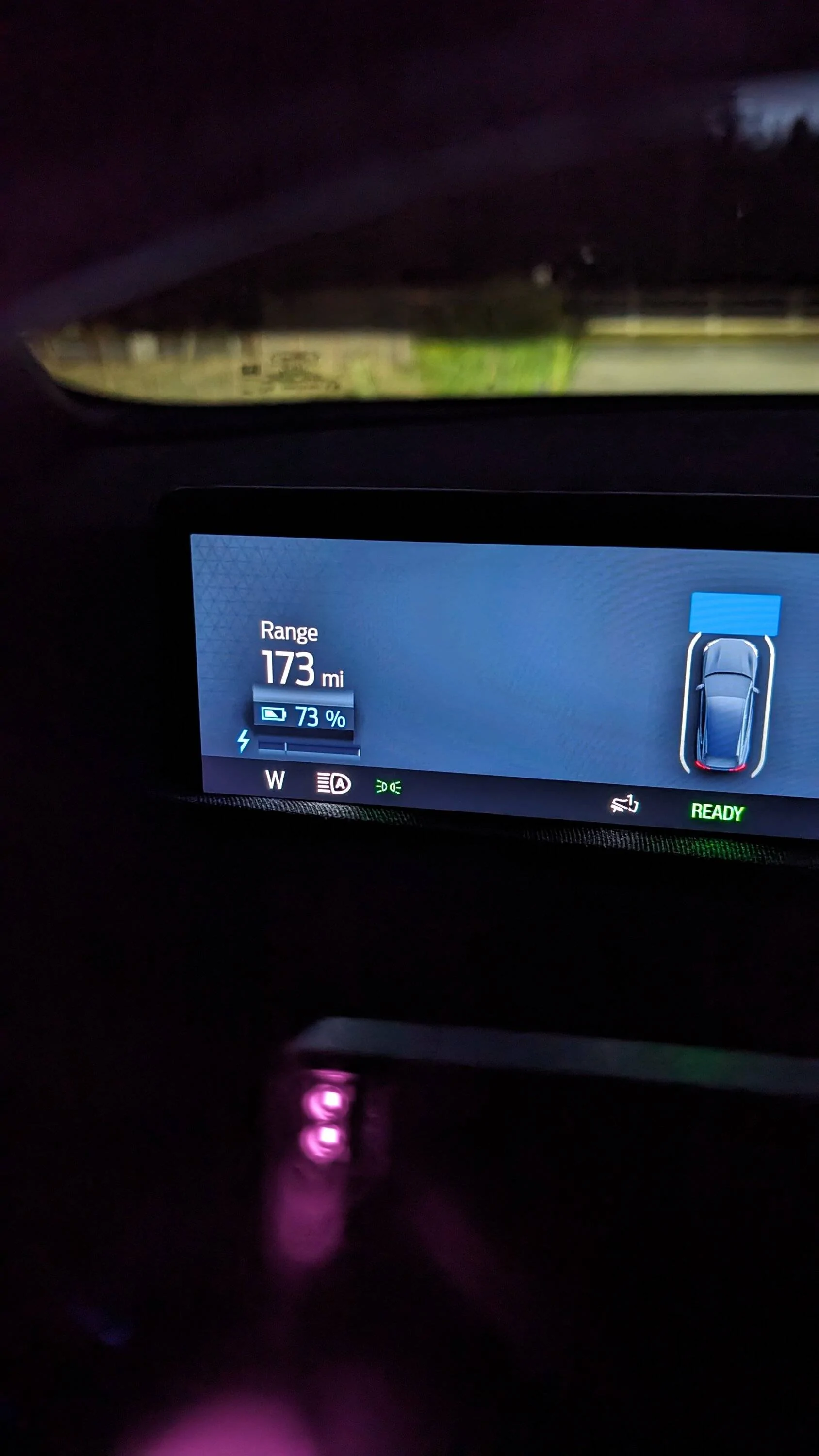

So, I just took the car out and ran some tests. It's 73 mph that adds 2 bars. I started with 1, went to 3. At 72 mph, after being above 73 mph via a slow climb, I immediately loose the 2 bars extra and go back to 1. This is exactly what I've been saying.
Now if I give it 3/4 throttle from 0-93, I get a f*ck ton of bars. After I drop below 72 mph, they are still present. Which is what I've been saying.
They are two totally different sets of bars. Yes there's bars at 73mph, there's another set of bars at 80mph and there's a whole different set of bars at 5-7 seconds, whatever the magical performance limiter is at. I'm not hard stuck on it being an exact 5 seconds, it's close to that. But it's a time limited run that adds bars.

Pretty sure it's a time based moving average. Something like amps^2 * seconds ≤ limit in a x second period. That video was like ~5.6 seconds before the limit kicked in hard.
What Todd is saying is correct. There's a slight limit that happens purely because of speed. Pretty sure this is indicating the reduced power output of the motors due to back EMF, which increases with motor speed and is just unavoidable physics. Then there is a separate power limit that comes in based off amp draw. Cold battery temps will also introduce their own power limit. And then there are limits related to low state of charge to protect the cells from excessive discharge.
When people talk about the 5 second limit, they are referring to the limit component that's the direct result of drawing a lot of power in a short time. Not the speed/temperature/SoC components, which are separate algorithms. The computer is looking at all the limit algorithms at the same time, and whichever limit component is greatest wins and is followed.
If Ford improves the 5 second power limit, you will still see the couple jail bars at high speed and at cold temps, those won't change. But hopefully the big time jail bars won't come in for a few more seconds at WOT compared to now.
If you do a run at 1/2 throttle, you'll get more seconds before the limit kicks in because the product of amps and seconds isn't as high as full throttle. It's just harder to know the jail bars aren't from speed vs. the amp draw because the speed bars might set faster than the amp draw product bars.
This whole thread is really just a bunch of semantics. People say "5 second rule" when talking about the time/amperage based power limit because it ends up being about 5 seconds at full throttle, hence the name. Not the best name for it, but it's not completely wrong either. Total clickbait thread title BTW. Snopes would rate your claim a 5-second rule doesn't exist as "mostly false."
