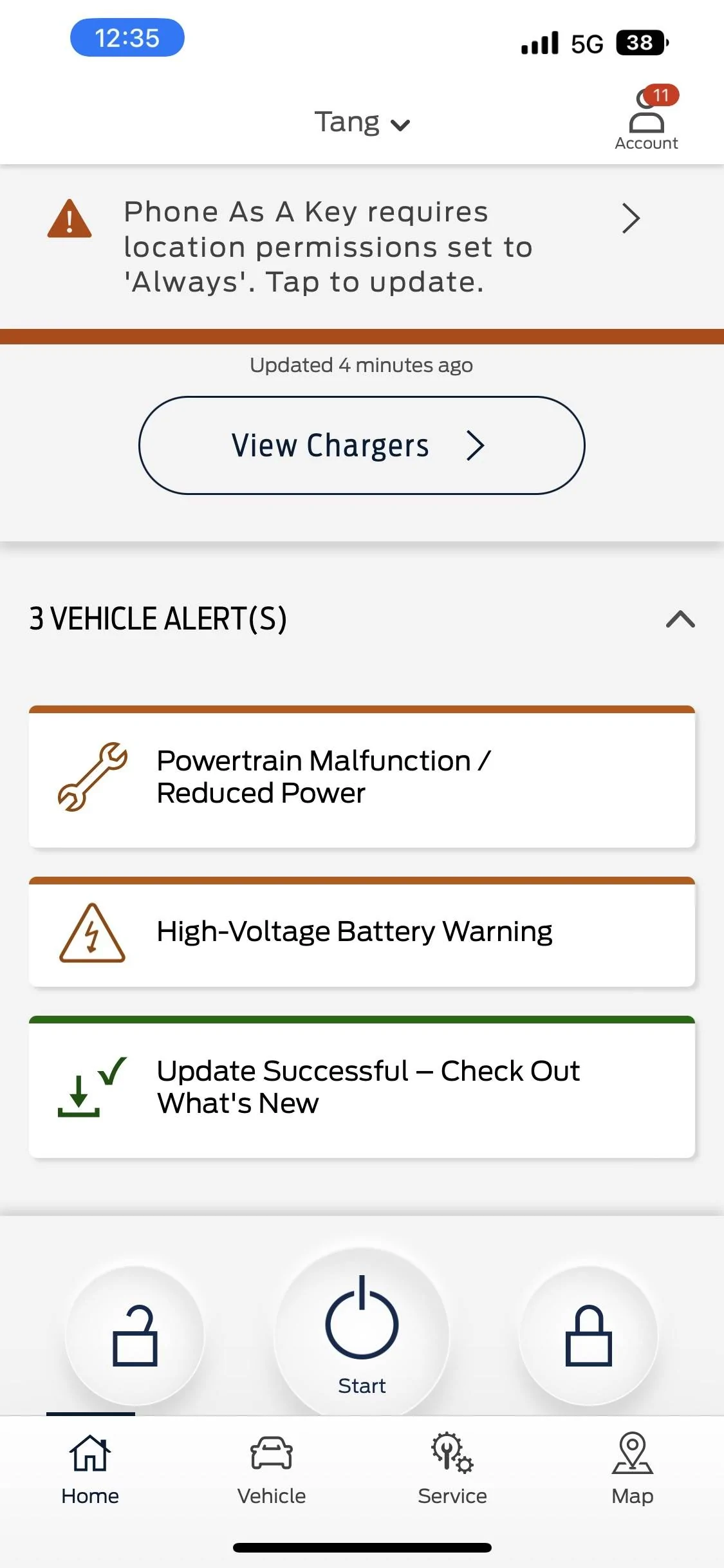

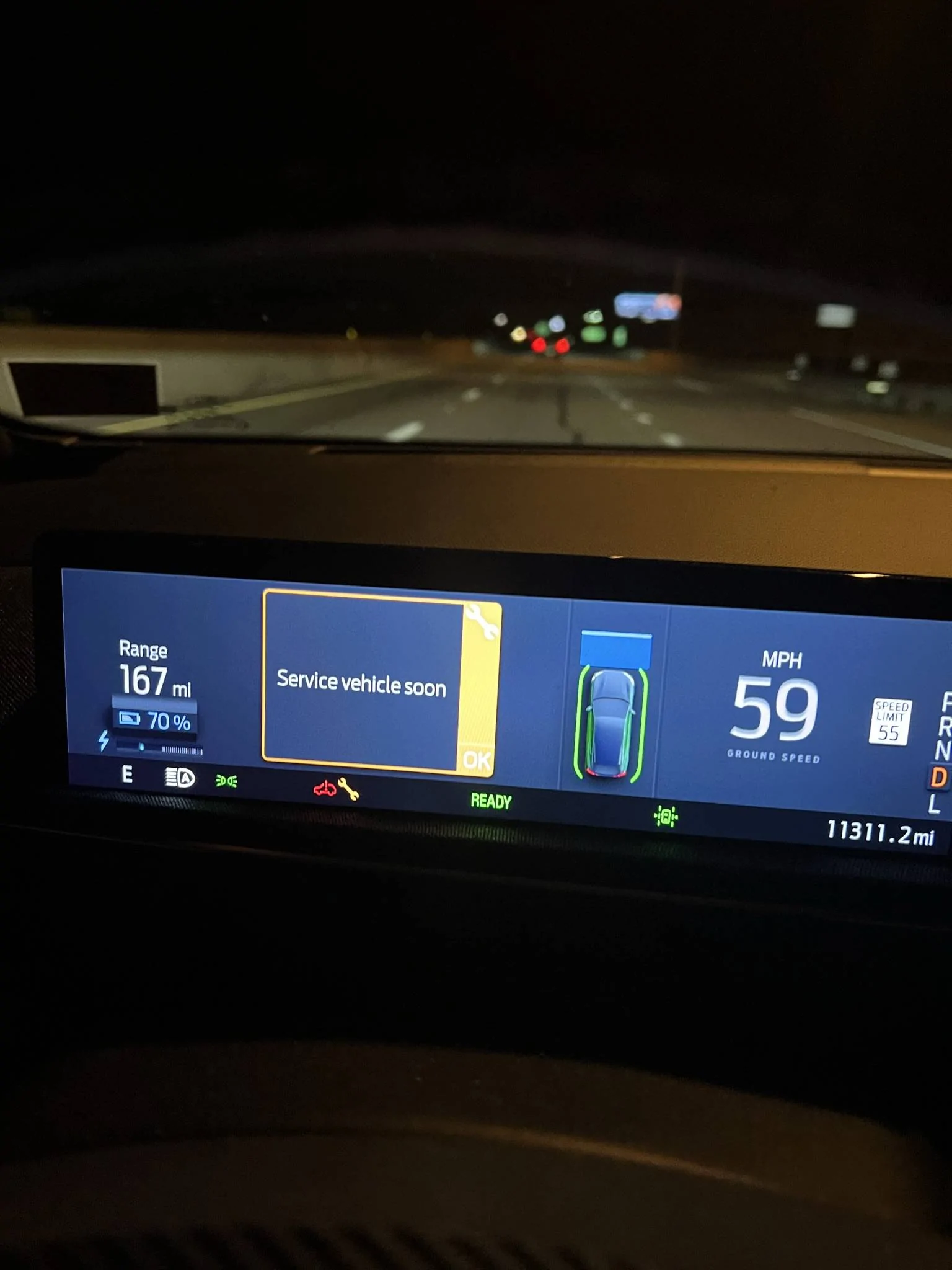

Hi everyone,
Two nights ago I was driving home on the highway and my Mach E GT Performance dashboard displayed the service vehicle soon alert followed by the car with explanation point in the middle. I just had my car serviced by ford too the day before. So my car went into limp or turtle mode, and my FordPass app said I had a high voltage battery warning and a power train warning. I was able to get it to my local ford dealership the next day, and they ran diagnostics and discovered that my battery junction box went. I only have 11k miles on the car. Just in case anyone else experiences this, I have attached pictures below. This part is of course on a major back order so Iām not sure when Iāll get it back
