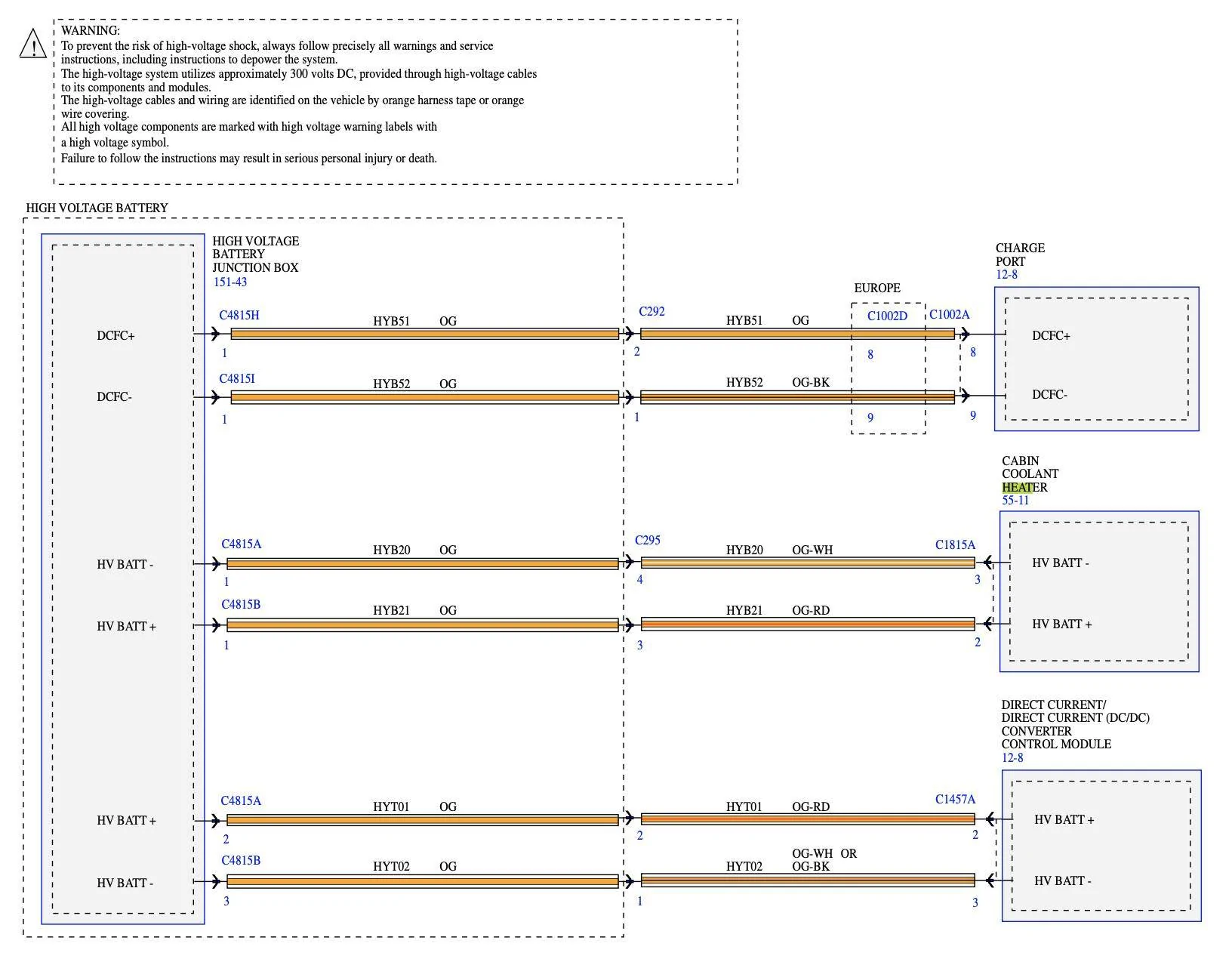

the dc-dc converter pulls from 400+v HV battery to run all the 12v 'stuff' like lights, radio, computers, and yes, e-heat. All the 'normal' heating/cooling accessories are designed for 12v because that's pretty common and available from existing ICE stuff.
this is WHY the dc-dc converter has a big fat circuit for 160amps.... expecting all the 12v loads to be up around 2000 watts, for heating and cooling.
with another dc-dc, we could have another dedicated heat-pump for cabin heat, or to provide 'performance chilling' for the inverter for performance loads well beyond 5 seconds. ;)
Everything (pumps, diverter, blower, etc) is 12V, except for the heating element itself, which is high voltage. This is common (heating element running on hv) in EVs, PHEVs and BEVs.
Thanks. It’s always good to see the facts once in a while on here.
