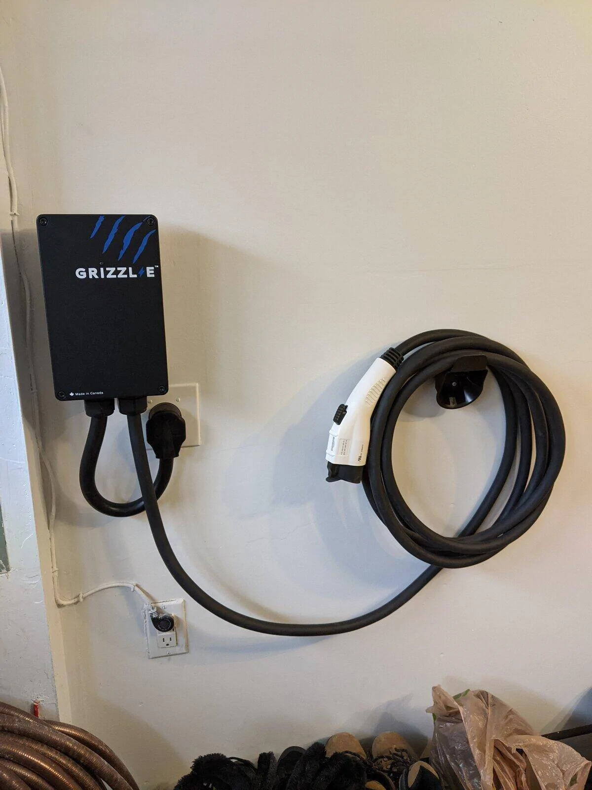

I just wanted to leave the mobile charger in the car, just in case I ever needed it away from home. I knew if I used it as my regular charger at home, I wouldn't bother moving it back to the car all the time.
Plus the Grizzl-E is more heavy duty and should last longer.
Plus the 30% federal (US) tax credit was set to expire last year (although has since been extended). Looked like an opportunity to get a deal.

Ok then - why just not to buy another Level 2 charger and use it with your 240v? It might cost less than $200 (maybe even Fed's 30% tax rebate?). And then you can have Ford's mobile in your car? Why go with spending $1000+ for the charger and the complex installation?
I think there might be a misunderstanding -
1. Ford's Mobile charger is essentially free, (included), so that's the emergency / backup one that's staying in the car.
2. I did buy a 240V EVSE and that remains permanently in the garage, ready to charge every time I come home. But I didn't spend thousands... I spent a few hundred. And it charges faster than the mobile one.
The Mobile one will be useful when I travel to areas around PA which have "EV Charging stations" at some parks and hotels that are simply a 120v or 240v outlet, no charger. There are very few EA chargers in PA. I'm not lugging a Grizzl-E charger with me to use those outlets. I'm keeping the mobile in, which has the flexibility of using either 120v or 240v depending on what I encounter.
Plus, it remains in the car all the time, and fits under the rear luggage compartment. I'll never forget it.

Ok, I think I got it - you mean you bought that ~$400-500 Grizzl-E and use it with your existing (or much easier installed than the most advanced, 48A one) 240v 50A configuration?
Yes exactly, I DIY'd an outlet for $50, and the Grizzl-E was $400. After the rebate, my total was like $300.
If it's a really complex install... maybe I'd forgo the Grizzl-e for now, and just use the mobile until later. But I'd really still want to have a standalone EVSE in the garage. It's more convenient.

Others have mostly covered it. For me:
  1. Plugging and unplugging into a 240V will wear the outlet to the point where it stops working eventually; they're not designed for that.
  2. So I can leave the mobile charger in the car at all times without needing to worry about forgetting it on a trip, or needing it in an emergency.
  3. Higher amperage EVSE's charge faster. If I get home late and need to leave again in a couple hours on a long trip, every additional amp matters.
  4. 30% off Tax credit.
  5. I DIY'd the whole thing for $450 including the Grizzl-e and the NEMA 14-50 outlet install, and then that came down to like $300 after the tax credit.
