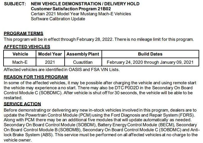

There is a screen where you can check if any OTA updates are available. For non-OTA updates, make sure your dealer know about this one:
Ford Mustang Mach-E Deep Sleep Mode - 12v battery drained dead [update: Mach-E jump started] e98c80ec-4ffd-40f7-ab7f-bcfbd610bf01-png.4384
