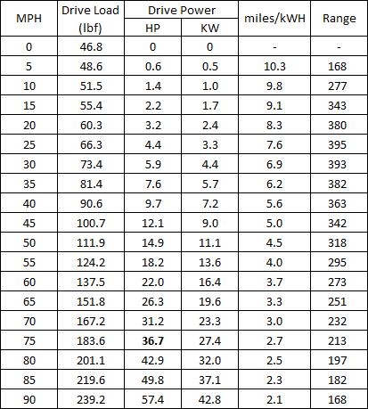

How many HP do you think you'll need to maintain a constant 75 MPH on a flat?
Good question, and one that I was curious about as well!
The short answer is about 37.
The long answer is the public EPA data lists the force required to move the car as a function of velocity, which gives us enough information to answer this. For the AWD version, this is the EPA equation:
Force (lbf) = 0.02086*V^2 + 0.2604*V + 46.77
That equation is all we need to calculate the drive power at different speeds. To estimate the range, I had to make some assumptions, which I'll list at the bottom.
Ford Mustang Mach-E Range concern 1612390865221
The range number in this graph assumes using all 88 kWh in the battery at 95% efficiency and a constant 2kW electric load for things like climate control and radio. To be fair, I just made those up because I don't know what the system efficiency is, and the "non-drive" electric load will vary greatly based on climate control especially. Also, this is accurate for the ambient conditions specified by the EPA, which I haven't been able to find yet.
It is eye opening how speed dependent the range is. This is something we should all keep in mind as "real world" range tests start coming out.

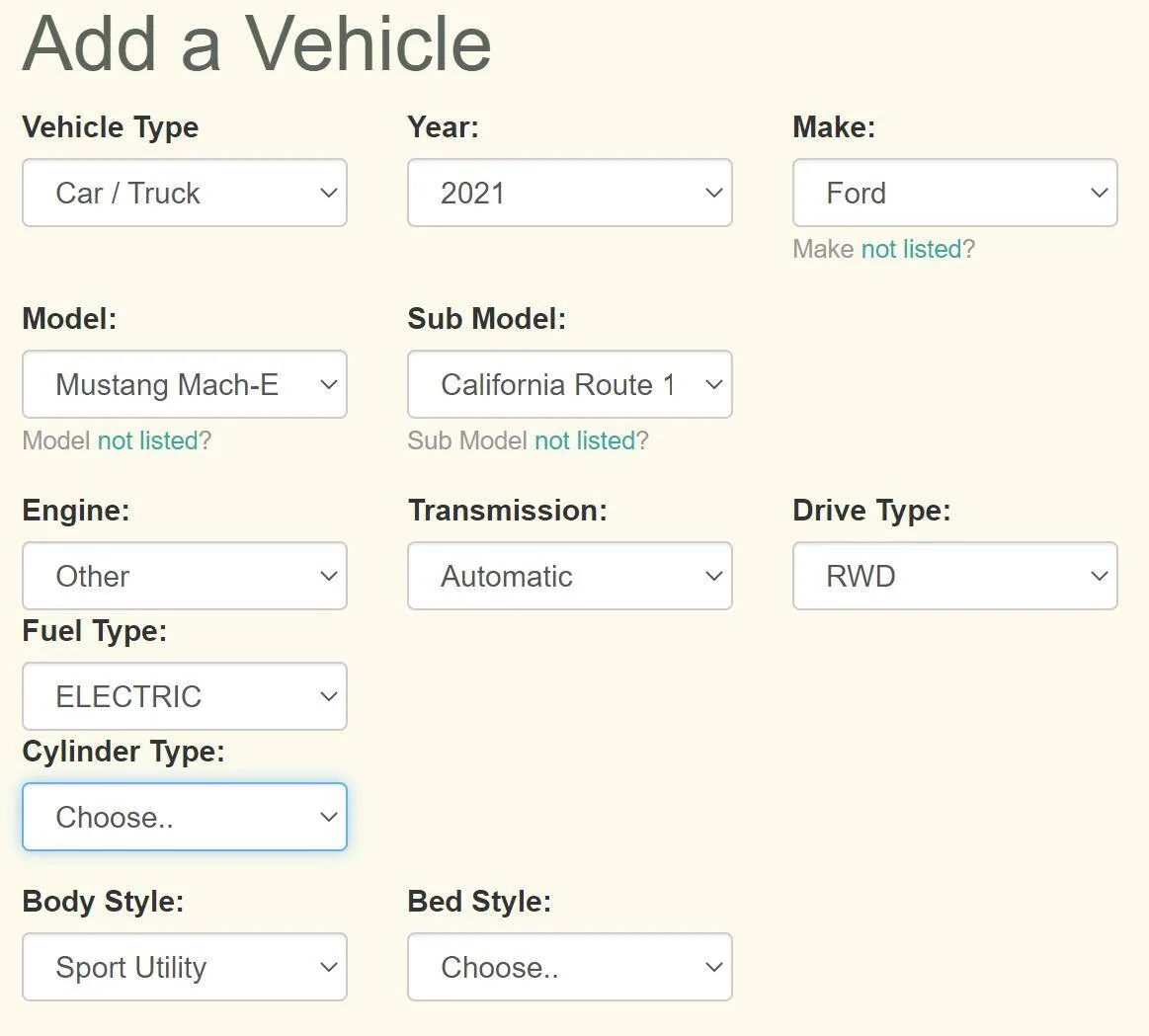

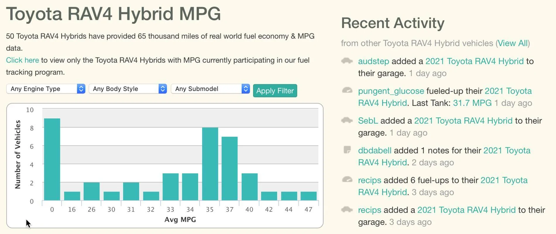

Is there a website or app that community members can log the BEV fill-ups (I guess it's really charge-ups).
On EVs, it would be better than gas cars since an app data sync should be possible.
Fully is a simple version of this for ICE cars:
You can use fuelly:
Ford Mustang Mach-E Range concern 1612395709602
(Wow; haven't used fuelly in a long time, forgot I had an account LOL)
Really nice chart!
I think the calculated numbers are too high, the estimated drive train efficiency is too high, and the power needed for accessories is way too high. The latter two tend to cancel out though.
But definitely in the ballpark. I'd guess 250 miles rather than 232 at 70 MPH but we'll see. For example I get over 3.5 miles/kWh for a Bolt in Freeway driving, which is mostly in the 68-78 MPH range. That's in hilly terrain which takes a toll even with regen.
As you point out, if you're worried about range use adaptive cruise control and reduce the speed to 68 MPH and be there. People act as if the car delivers a certain range. In practice the car delivers a certain number of kWh and the three Ts determine how many miles those kWh turn into.
