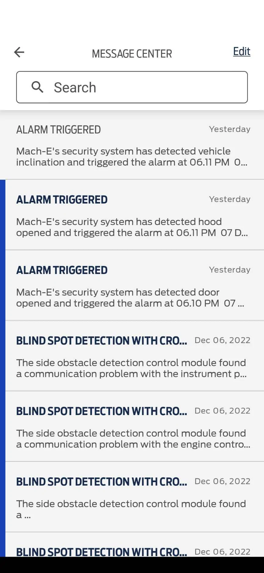

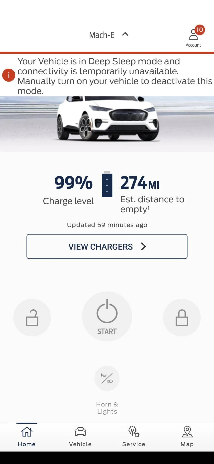

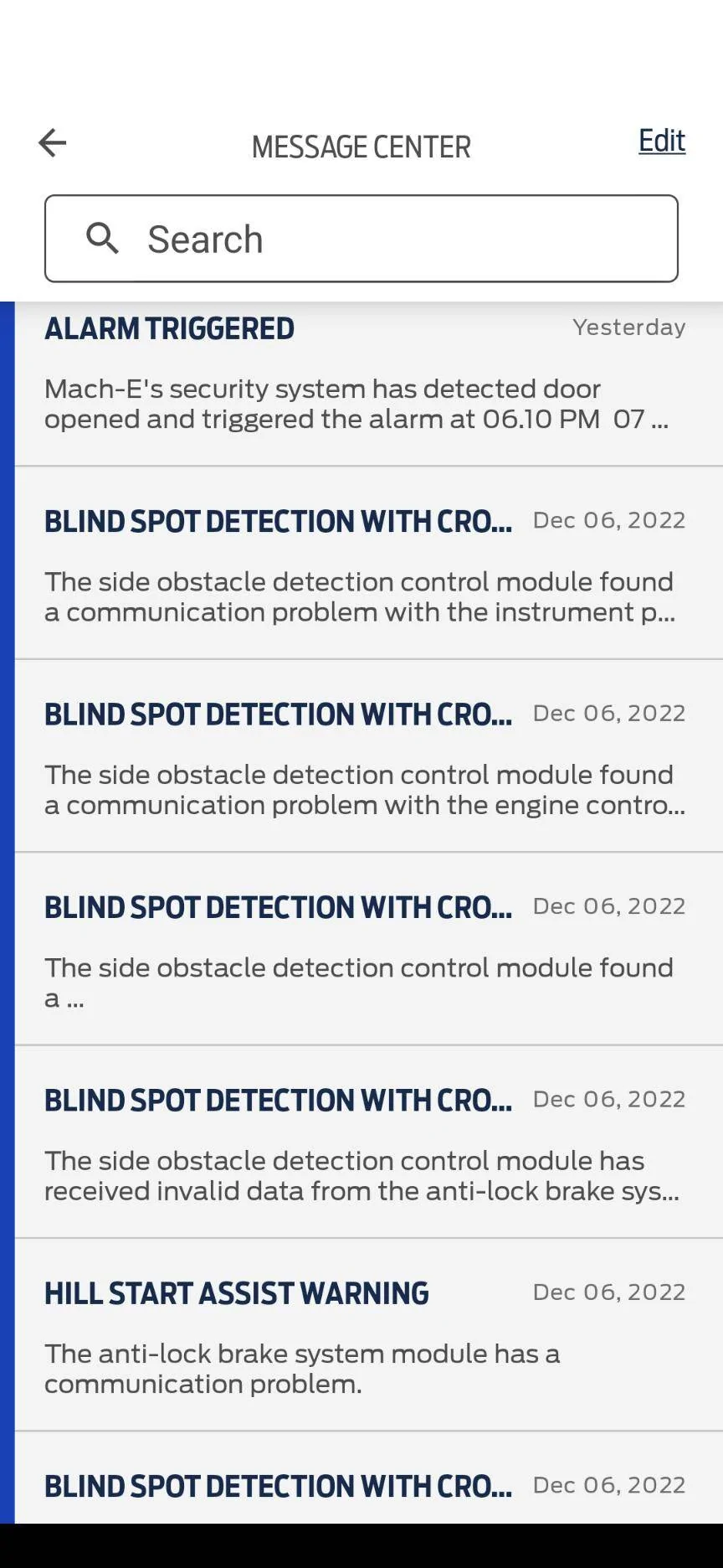

A few of the messages from Ford Pass.
These just in the app? Just force close the app and forget it? Know the car did spit out a whole lot of messages at you when the cars 12V is too low but never saw the app do it. Maybe progress? It is the car you care about forget the app.
It is not easy being green and yep appears something is not working in yours like it is for others. Bummer but they should fix it. Are you sure they currently have 3 Mach-E in front of you with the exact same issues?
Are you still locked out? Did you get a 12V charger on it? Is it still sitting at your place?
