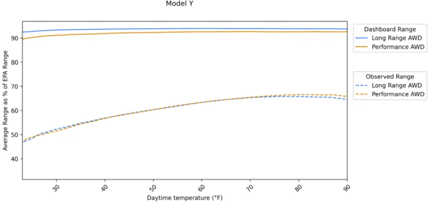

I stopped around page 8 so maybe somebody said this, but I think this definitively proves why Tesla does their range estimate the way they do.
mkhuffman
Nov 19, 2020
6,875
9,507

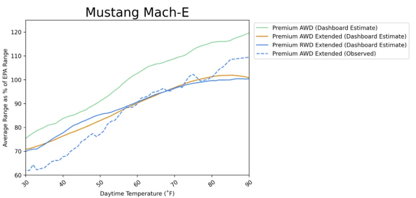

Yeah, it has been a common debating topic here. And check this out:
Ford Mustang Mach-E Ordered Extended Range Battery, Got the Standard 1672710088122
Ford Mustang Mach-E Ordered Extended Range Battery, Got the Standard 1672710125826
Ford does a pretty good job with the GOM, and Tesla does not. But Tesla drivers are not going on forums to find out if they have the wrong battery either.
