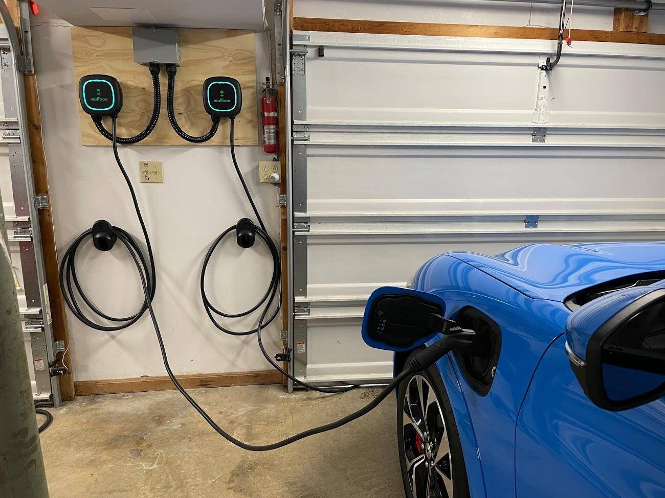

I have 2 Wallbox Pulsar Pluses using Power Sharing on a 50A circuit. Have been working well since I installed in February (charging my Mach-E and i3).

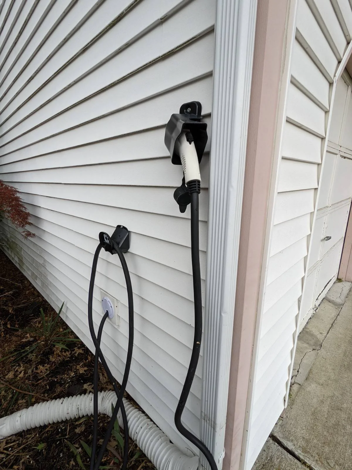

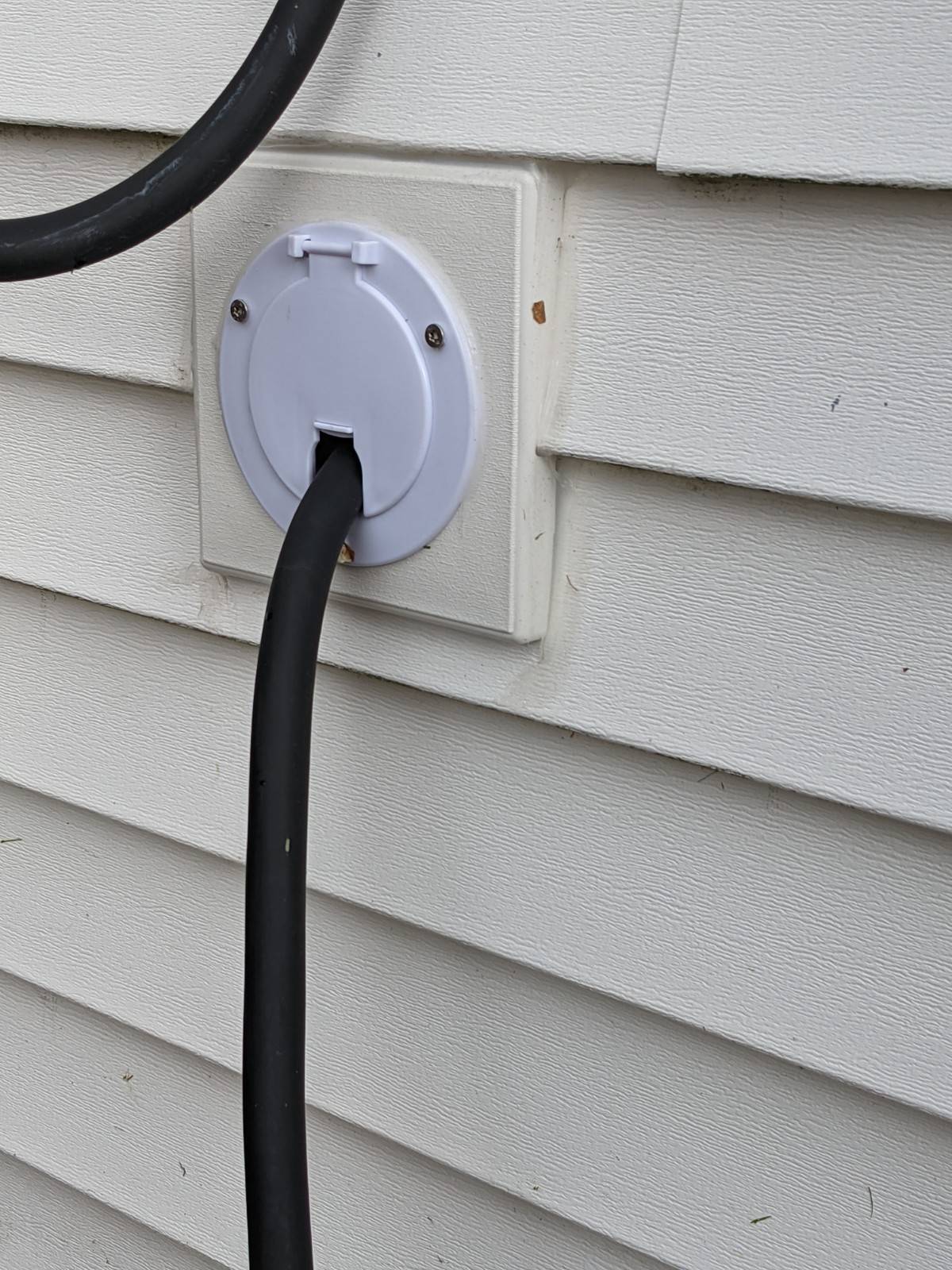

My charger is in my crowded 1 car garage and I park outside, so I used an RV access port cover to make an access port in the wall for the j1772 and cable, and use a clippercreek holster with my Grizzl-E because it is side mounted and seems much more weatherproof:

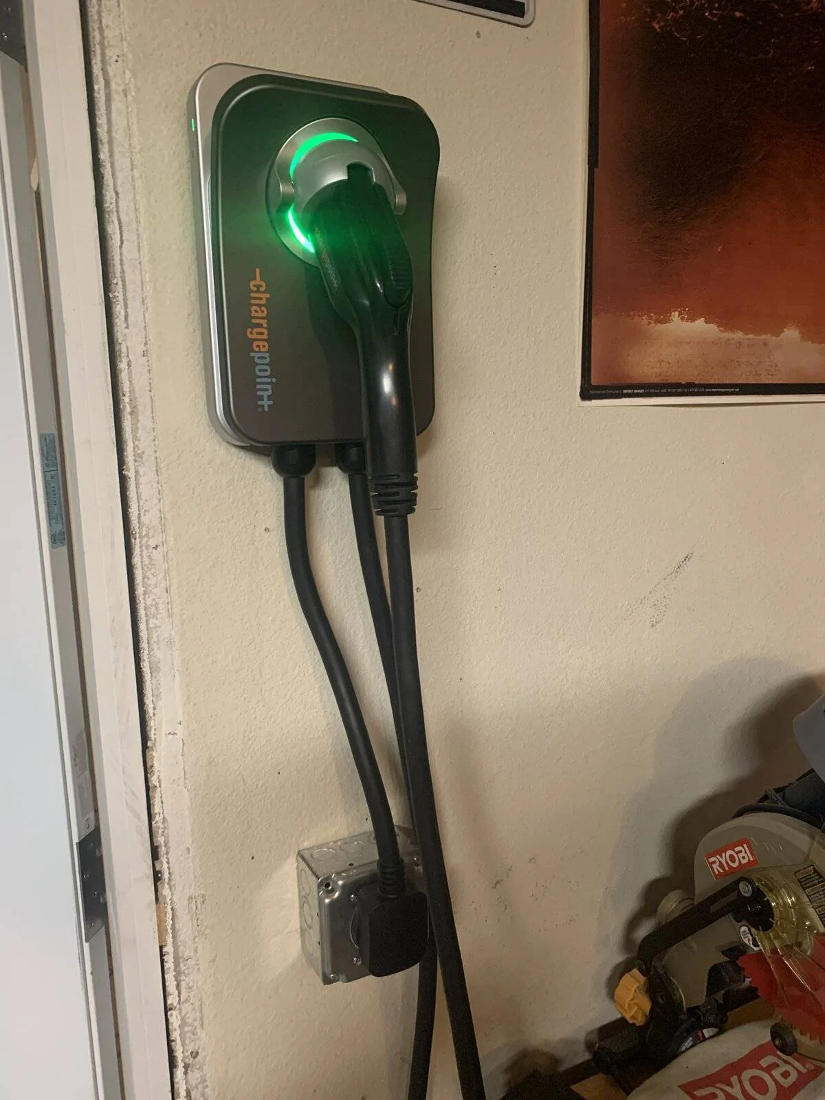

Been using the provided 32A Ford charger that came with the car until my ChargePoint arrived today.
Delivery took approx 4 weeks from time of purchase from the manufacturer’s website.
I went with the NEMA 14-50 plug-in configured for 40A. I didn’t want something hard wired in case there was a need for replacement/swap in the future and didn’t see a need to charge anything faster than 40A.
If I need DCFC, for any reason, there is a brand new 150 kWH / 4 stall - EA station approx 1.5 miles away from my house.

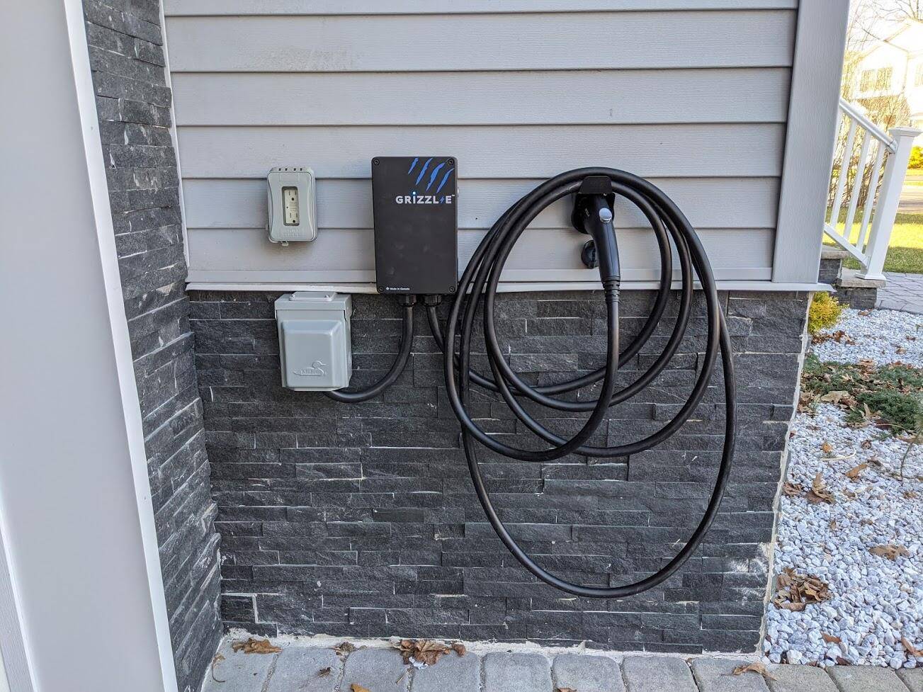

I also went with the Grizzl-E 40A Classic and could not be happier with it. Sprung for the longer 24ft "premium" charging cable and mounted it to a NEMA 14-50 right outside the garage.
Ford Mustang Mach-E What level 2 charger is everyone purchasing for home use? 1624561195749
P.S. Now that the cable is "trained", I swear it looks a lot neater than this ?
